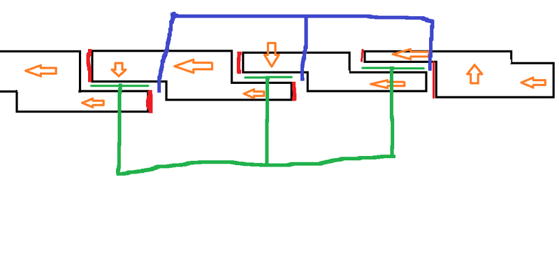

Per @hutchphd question I am explaining further.
Idea is theoretically simple. I have a core and a coil on the core, the whole arrangement being wideband somewhat like a wideband balun only this is not a balun operation. So I drive the coil with varying RF frequency per my need and my core develops flux , there is now flux at the airgap ,. this flux passes a conductor of certain thickness and width (most likely a litz planar strip or similar) now there is some corresponding RF induced in my secondary loop which the one circuit that connects to the strip passing the core flux in the airgap.
What I would want is for this secondary current to not affect the flux in my core in any way.
So that only the primary coil induced current affects the core flux but not the current in the secondary circuit of which the strip passing the core airgap is one part.
I have thought of different geometries for the core and strip loop but I can't come up with anyone that would function only in the direction that I specified, especially if I have multiple strips and multiple cores stacked together whereby each strip and it's associated circuit forms a single loop or a half loop around the core anyway.
I would ideally go for a simple wire coil and core setup and not a specific waveguide/circulator waveguide one as that would severely limit the frequency range.I made a rather appalling sketch in MS paint (see attached) to explain in bit more detail my own attempt at this. You can see a multiple parallel core like structure which is toroidal but made up of small individual cores (black rectangular boxes) , the viewer is looking at the sructure from the outer side of it, the orange arrows show the B field in the cores. The red lines at the ends are conducting solid copper "field stoppers" so that the field leaps in the direction envisioned by the arrows and not just straight , the copper stops the field with eddy current induced back EMF.
The green lines represent the conductor strips in the airgaps of the core. The flux crosses the green conductors in the airgaps. the blue/purple lines represent the primary coil.
As you can see any current in the purple wires will induce flux in the core as the wires loop the core, but so do the green strips in the airgaps so current in those will induce also flux in the core which is what I don't want.
  • Hand-drawn diagram of a looping conductor path with orange arrows showing current direction, red marks on the conductor, and blue and green lines indicating connections between segments.

Well in fact this is not my problem, here is why I think so.
Now suppose the current in my primary ramps up in the positive half cycle, the flux in my core increases , also the flux in my airgap increases. So far so good. Now due to the design of this circuit the increased flux creates a Lorentz force in the conductor in the airgap, there is a sense element in the secondary circuit so that it generates current proportionally to the field strength in the airgap.
The problem is that due to the way this airgap conductor wraps around the core that a current in it will create additional flux in the core. This will result in a situation where the primary current goes down in the positive half cycle but now the current in the secondary creates additional flux in the same direction so the current in the circuit doesn't go down, a feedback is established which now makes the current in the circuit DC and the flux in the core steady and not changing.
Due to the current in this secondary being stronger than the one in primary the primary current won't be able to change this steady state.What I would like is for it work like this - primary coil current (RF) creates an RF flux in the core, this flux also exists in the airgap , the secondary senses this flux and generates a current that is in phase with the flux in the airgap, as the flux in the airgap decreases the current in the conductor in the airgap also experiences decreasing current. But as I said this cannot happen if the conductor in the airgap continues to create flux in the core because that flux would then exist in the airgap and the current in the conductor following this airgap flux would never cease due to feedback.

Do you think that there is no magnetic flux across the air gaps?
Frankly I do not understand your diagram at all. The "wires"do not make circuits so what flux are you describing?
Hand-drawn diagram of a closed magnetic core loop with black outlines, orange arrows showing flux direction, red marks at gaps, and blue and green lines tracing connections between sections.
Yes pardon my drawing skills. The blue wires are meant to represent normal wires that loop around the core as seen in the drawing, they are all connected together to represent they are in parallel but that is beyond the point.
The green flat lines represent a think flat conductor located in the airgap of the cores, the green wires attaching to these green flat strips simply represent wires attaching at the bottom and top of the strip and then going away forming a closed circuit.
Now I actually don't need for this to work as a transformer , in fact the transformer effect is unwanted in my case. I only needed a core that gives flux in an airgap so that I can then use that flux for my flat conductors.
The problem - the fact that when closing a circuit with these flat conductors they seems to form a loop similar to that of the primary (blue) around the cores and any current in the might generate additional flux in the core, if DC it could saturate the core or lower it's usable permeability.
artis said:
how about a secondary winding that isn't a winding but merely a conductor that has to cross the core through an airgap in it, yet doesn't have to be linked/looped by the core
Current must flow in that secondary wire to get a Lorentz force. That means it must loop back to the source to make a closed circuit. If that loop encloses any of the flux in the core you have made a transformer. There is no such thing as a circuit that links flux in the core but isn't a loop. OK maybe it's a really big loop that is mostly outside of the B-field, but it's still a loop.
I suspect that your solution is to make a very high impedance current source to drive the secondary winding (the one in the gap) so that it's current doesn't change when the primary induces voltage in it as the flux changes. Then, of course, this would be combined (compared with) with a very low impedance voltage source driving the primary. This, theoretically, won't change the flux in the core because it will appear as an open circuit to the primary.
But, in spite of the several attempts you've made to describe your system, I still don't really understand either the geometry or the circuits. Perhaps I'm too lazy to read that carefully.

It's funny , maybe you won't fully understand my system but I think I fully understood what you are saying and combined with what I already know I think you are right , the basic fact here is this
I think this is what spoils it and what I already suspected because once I made a drawing I saw this loop being there, and I cannot put a very high impedance in the secondary sadly.
