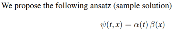

Printed text reading "We propose the following ansatz (sample solution)", followed by the equation psi(t, x) = alpha(t) beta(x).

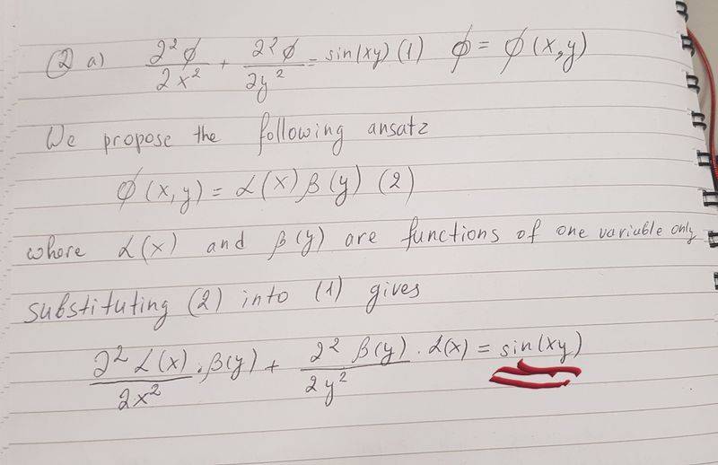

Handwritten derivation on lined paper: PDE d²φ/dx² + d²φ/dy² = sin(xy), ansatz φ(x,y) = α(x)β(y) substituted to give α''β + αβ'' = sin(xy), with sin(xy) underlined in red.
[/B]
Could you tell me is there something specific that I need to the with sin(xy)? Thanks

You can proceed with the method of separating variables and divide both sides by ##\alpha(x) \beta(y)##. Does it look like this equation is separable?
Yeah it seems like this is not a separable equation :(
