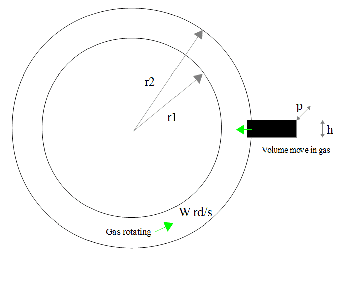

I would like to calculate the energy need for move in the black volume in gas (move in from r2 to r1), when gas is under rotating movement. The black volume turn at the same speed than gas. The weight of black volume is considered like 0. Like rotating create centripetal force, the pressure at external circle is more important than at internal, so it's not easy. Is it possible to calculate function of Gas, T, P, r1, r2, h, p, W and how can I do ? Consider "torus" like a square section and close.
At first, my idea is to say the temperature of gas don't change because gas rotating, so if the temperature don't change it's like put volume in gas without rotating but I'm not sure, could you help me ?

If h is small compared to r1 and r2, you can neglect the rotation (and the compression due to the reduced volume) - it will lead to different pressures inside+outside, but the average pressure is the same unless you heat your gas. The approximation is better if the black thing is shaped like a part of a circular sector.
Yes take a part of circular sector
This even W is very high ? Could you explain a little more ? H can be greater if it's a part of circular sector ?
If the black thing is a part of a circular sector, it will remove some fixed fraction of the volume - and that fraction is the same for all distances to the center.
If h is small compared to r1 and r2, you won't compress the gas much, therefore the required energy is just the pressure, integrated over the volume you take away.
An ideal gas has a fixed pressure<->density ratio, therefore the required energy is proportional to the mass within the volume you take away - and that does not depend on the rotation.
If your black thing has a different shape, things are different.
I don't understand how shape modify the result, could you explain ?
Consider a high rotation speed (gas on the outside) and a ">"-shaped object (object mainly at the inner part): Gas and object are at different places, nearly no energy required. In contrast, a "<"-shape would have to remove much gas there.

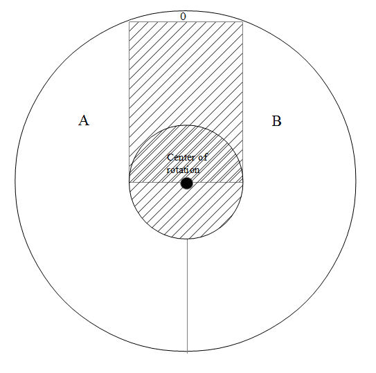

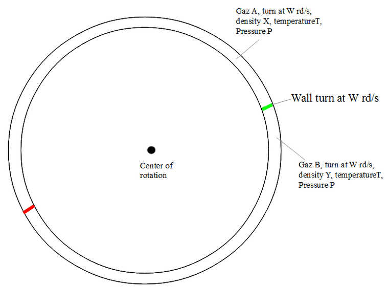

2/ I have another question about torque with 2 different density of gas. I'm interesting about green wall only (not red). If Y>X (see drawing) the gas B will be more at external circle than gas A, so the temperature give more torque from B than from A because the radius is not the same ?
Again: Temperature?
As shown before, for ideal gases, the integral of the pressure over the wall does not depend on the rotation.

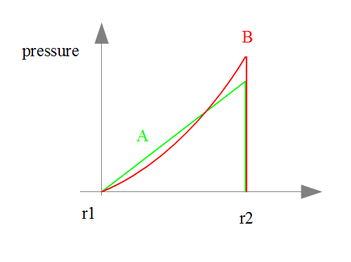

Sorry, I did not mean temperature but pressure. The repartition of the pressure is not the same with gas A and B, true ? So, with the effect of radius the torque is not the same ? Second drawing show two integrals, they have same value but not the same repartition by radius and when calculate torque it's not the same ?
Right.
Probably, but the effect should be small.
The red wall receives the opposite value then.

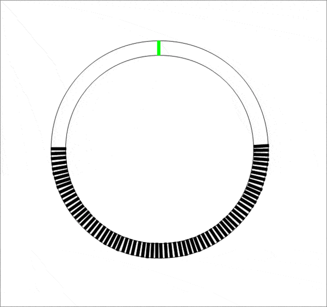

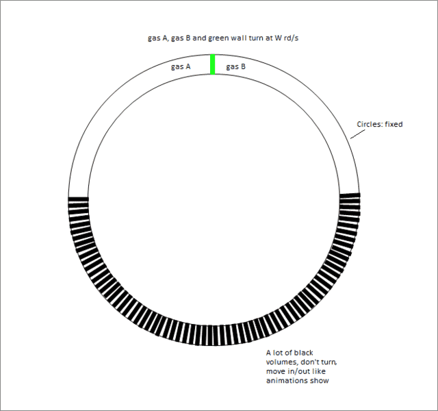

You're right, so with the animations, nothing turn except gas A, gas B and green wall (circles don't turn, no reason for that). This seems a possible mechanical movement, So like green wall recover torque while it rotate, something must be wrong in this movement ? I drawn black volume move in/out at external circle but it's more interesting to move in/out like altitude (other plane) like that this don't change the repartition of gas in volume.

Sorry, this is getting to weird for me and I have no idea what you try to find out. I think you have some underlying problem in mind, but I cannot see it in the thread.
Maybe animations are not clear, I would like to see if it's possible to rotate green wall without have red wall (message #7) with this method. Temperature of gas A and B is constant, for example at 290°K regulated from external. Volume of gas A and B is constant like simulations show. So pressure is constant. I think a torque exist on green wall, this is logical. I think energy needed for remove one black volume is the same than move in it because it's the same temperature and pressure for gas A and B. Black volumes and circles don't turn. Only gas A, B and green wall turn. Maybe this need some numerical simulation but I don't understand why this mechanical movement is not possible. Like this would break 2nd law of thermodynamics I think it's not possible too.

With this shape I don't know how torques could be cancel themselves ? Repartition are not the same and radius change in the same time.
A = Gas A of density 1
B = Gas B of density 2
