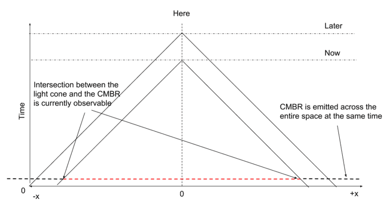

Tom Mcfarland said:
Has this claim actually been verified
The surface of last scattering was a finite time ago, and light travels at a finite speed. That means we are only seeing a finite intersection of our past light cone with the surface of last scattering.
If you're asking how we know that finite intersection does not comprise the entirety of the surface of last scattering, we know that if the spatial topology of our universe were in fact ##S^3##, its radius of curvature would have to be much, much larger than the size of our observable universe. That ensures that the portion we see of the surface of last scattering is only a portion; it can't be the whole surface. If it were, we would see strong evidence of positive spatial curvature, and we don't.
Tom Mcfarland said:
We have a 4-ball bounded by a space-like S containing the (invisible) early universe. and another 4-ball containing the visible universe, also bounded by S.
In other words, S is the surface of last scattering. If that is the case, then we have two 4-balls, separated by a spacelike 3-surface, yes. But you have not shown that that spacelike 3-surface is an ##S^3##. See below.
Tom Mcfarland said:
As before, we merge these two objects by identifying their common boundaries S. We now have a universe with one time dimension (t = 0 to now)
Yes. But what topology does this 4-manifold have? You are claiming that it has topology ##S^3 \times R##; but you haven't shown that. See below.
Tom Mcfarland said:
and whose spatial context is S³ (positive curvature, not flat).
Nope. The construction of an ##S^3## by merging two 3-balls works like this: you have two 3-balls, each with a 2-sphere as a boundary. You identify the two boundaries and "glue" the two 3-balls together at their common boundary; the resulting manifold is then an ##S^3##.
But in the case you are describing, you have two 4-balls, each bounded by the same 3-surface. But you can't assume that that 3-surface (the surface of last scattering) is an ##S^3##; that's what you are trying to prove. So you can't show that the 4-manifold you get when you "glue" the two 4-balls together at their common boundary has topology ##S^3 \times R##, which is what you are claiming.

@Tom Mcfarland the example of CMBR emission in static space-time described by Peter in post #29 can be represented on a space-time diagram with two spatial dimensions suppressed:
The triangles represent paths of light (null worldlines), which in the case with one spatial dimension suppresed (2D+time) become cones. Hence 'light cones'.
The dashed line is a spatial slice of constant time representing the universe undergoing transition into trasparent state; it is the time when CMBR was emitted. It is a line in 1+1, a surface in 2+1 (hence the 'surface of last scattering'), and a volume in 3+1.
The intersection points in 2+1 dimensions become a circle, and in 3+1 dimensions - a sphere. That's the currently observable snapshot of the surface of last scattering.
The portion of the surface of last scattering enclosed by the observable 2-sphere at intersection with light cones is a 3-ball (marked as red dashed line). The exterior is the entire 3D volume with the 3-ball cut off.
The observable portion of the surface of last scattering grows as the apex of the light cone travels into the future.

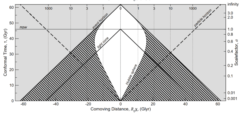

It should be noted that the above space-time diagram is applicable both to the static and expanding cases. All we have to do is use appropriate scaling for the axes. In the static case, the scaling is linear. For the expanding universe, using comoving distance vs conformal time recovers the above shape, as can be seen on the following diagram:
(source for the second diagram: Lineweaver & Davis, 2003; fig. 1)
... and the same relationships apply.
None of this is strictly speaking relevant to the topology of the universe, I think.
