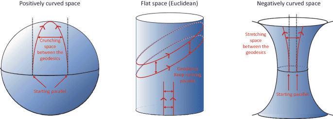

The "flat" picture is of a cylinder, which is not the spatial topology of our universe in our best current model.
Where did you get these pictures from?
Yeah, they're not the best. There's plenty of diagrams out there. I just hoped to start a discussion for the OP about what curvature is, as opposed to what it's not.
