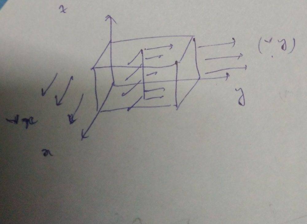

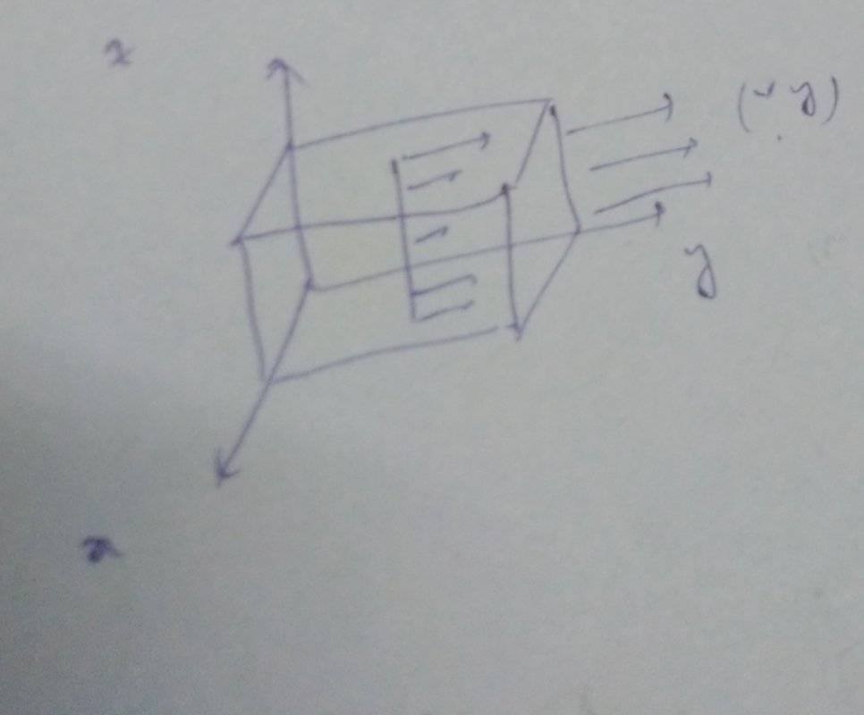

I have made a schematic diagram and try to relate things(Newtonian fluid) ,
For 1-D motion
The shear stress is ##\sigma=\mu\frac{\partial v_y}{\partial z}|_{(x,y)}##
For 2-D motion
Is the shear stress will be ##\sigma=\mu(\frac{\partial v_x}{\partial z}+\frac{\partial v_y}{\partial z})|_{(x,y)}##
If not then what will be it in this context??
For 1-D motion View attachment 243307
For 2-D motion
In the author's development, ##\mu## is equal to zero.
