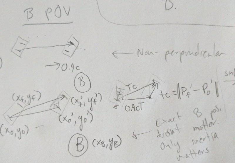

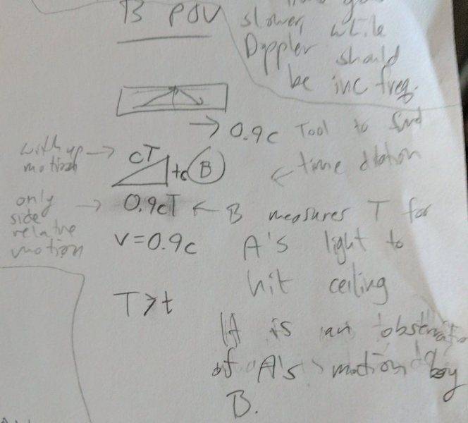

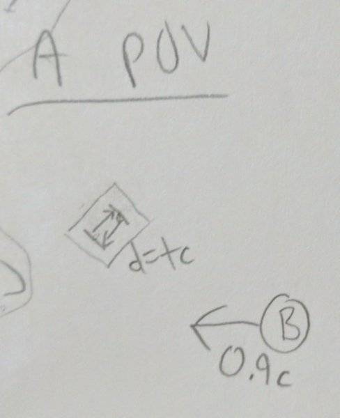

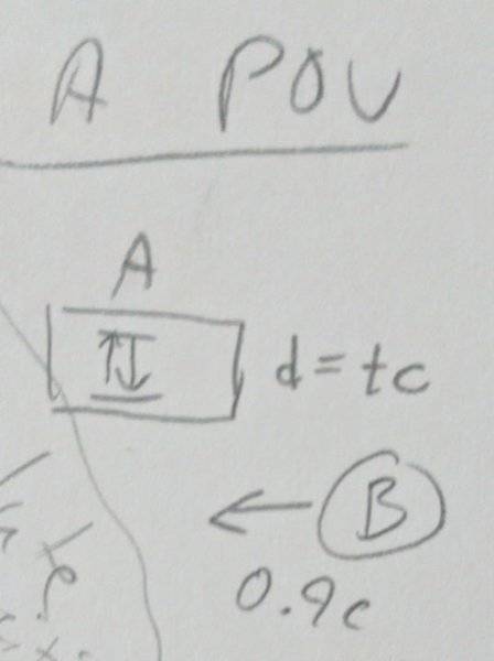

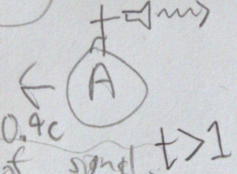

The points in the post Shining light beam back -- relativity still can't be answered. It seems there should be a slowdown of time at all levels of physics for objects moving in a certain direction so that if it is compared to light, it will always be c. This would lead to weird chemistry though. I don't know the answer but it seems relativity is incomplete.
Huh? Time locally always runs at one second per second. Are you saying otherwise?
There is time dilation so time runs slower for somebody. But to them it will appear others are faster, or else you make it really absurd and say "everything is possible, ooh, quantum observers," (many world's interpretation) and it seems to me it is that direction of thought that has been over-extrapolated. You can always film others and if they see themselves they must admit that their relativity was violated, or else it resolves. I think that relativity just hasn't been thought through to the end.
I have no idea what you are talking about. None of that seems to make any sense.
Let's go back to my question, which you did not answer:
I can't quite follow what's going on in your pictures (they are a little messy and disorganized and I don't usually do relativity equations), but the basic questions you raised about whether the direction of the velocity matters and how time passes for different observers has been answered for 100 years. There are few known inconsistencies, if any.

The points in the post Shining light beam back -- relativity still can't be answered ... it seems relativity is incomplete.
Well, your understanding seems incomplete, but that isn't the same thing. Why don't you wait to learn a bit more before rushing to a hasty judgement? It took me about 7 years of occasional study to get it.
We are glad to help you learn faster than I did, but you need to understand that this forum supports education about relativity and not debate about relativity.
