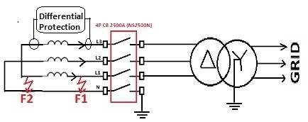

Hi guys,
Kind of newbie in this forum, i would like to ask your opinion in the following issue.
I have an application using one Generator (50Hz-400Volts) connected in parallel to the grid (50Hz-20kV) thru a step up transformer (Ynd, 0,4 to 20kV).
I have performed a short circuit study for single phase to ground short circuit on the LV side of the system just after the generator.
You can have an overview of the SC results in the attached file.
Looking in the picture bellow, the SC result represents actually fault current at location F1.
My question is that in case short circuit (single line to ground) happens in F2, do you think that the fault current would be zero...?

Ya its 0 acording to ohms law in basics

At the spot you have shown F2 probably a very few amps. Think about it - what is there to develop voltage? Just stray flux coupling the wiring, and whatever voltage is developed across the wire by neutral current from unbalance.

Ok... What really confuses me is the fact that in the same sketch, currents measured by differential protection device at two winding ends (F1 and F2) is exactly the same (when everything works ok).
So playing in reality with my 87G device in this application, i can read same load current on point F1 and F2.
So i was wondering by the fact that if i have same load current at point F2 (i.e 1000Amps, same as F1 = load consumption) maybe if a shortcircuit happens at point F2 that would give me the same fault current as of point F1
Shortcircuit from where to where? Where your arrows show?
your F2 fault connects two places on the same neutral. So there's no voltage difference to drive current through that red arrow.
Your F1 fault connects opposite ends of a phase so there's full capacity of generator to drive current through that red arrow. Plus the contribution backward from grid through transformer.
Draw them both on paper and work it with laws of kirchhoff and ohm using a pencil instead of the computer program. Just do steady state to prove principle and it won't take so long.
Well sure, what goes in one end of a good winding will come out the other .
If a fault let's current bypass the CT at either end that's a dead giveaway the winding has grown another way in or out - it's faulted. And your differential relay trips the machine immediately.
If fault current is same at both ends of the winding, the fault is someplace else.
Well, thank you guys for your valuable support.
I have to admit that was some kind of stupid (or "rush") thought of mine to worry for a short circuit fault current in F2 red arrow , since it is obvious there is not any kind of resistance , no voltage , no current.

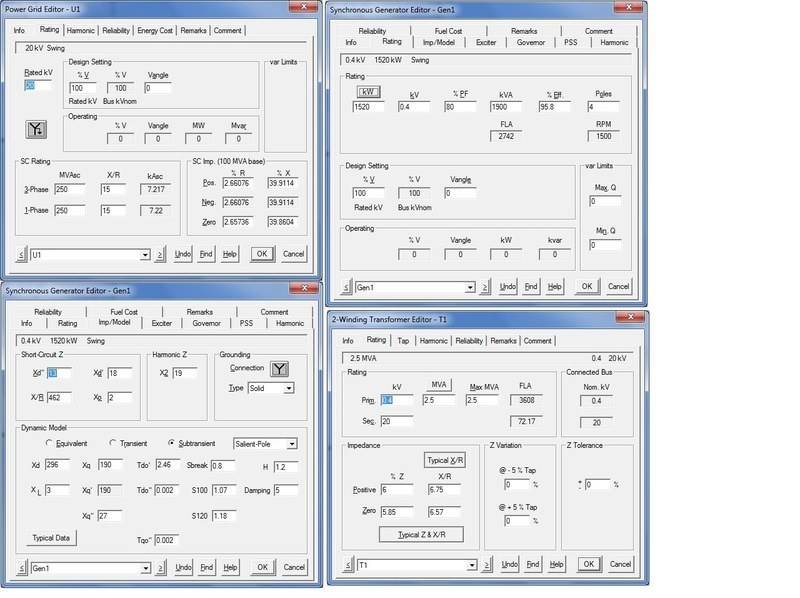

In the same configuration as shown in my initial sketch, taking into account the short circuit study performed (line to ground) i have the following results:
Faulty Point : F1
Fault Current by Generator : 46 kA (line to ground)
Fault Current by Grid : 40 kA (line to ground)
Total Fault Current : 86kA at F1
Do you think that is necessary the particular LV Generator to be grounded thru a resistance (or reactance) or it can be solidly grounded...?
For sure using a kind of resistance / reactance at alternator's neutral would result in much lower line-to-ground fault currents since grounding impedance will limit enough the line to ground fault current, but according to my understanding solid grounding is not mandatory as long as the alternator is not in danger and as long as all equipment is sized correctly to withstand 86 kA of total fault current (busbars, cables, circuit breakers, etc).
I would like your comments in this issue as well.

Yes that's why high impedance grounding is used, it leaves the machine in need of a lot less extensive repair.
One of our huge generators developed a ground when a wrench that had been left inside fell down across a terminal. Of course it was much larger machine than yours, but imagine the explosion that would have resulted from unlimited current. Instead the guys retrieved the wrench and wiped away a little soot.
I don't know your installation so can't tell what makes best sense for you.
BUt the IEEE "Green Book" is the best educational reference on the subject that i know of. There should be a copy in your engineering lobrary. If not, spring for the $29 and get your personal copy. It conveys the concepts very well. You will use it often in your career

In any case, the configuration of my system is advised in the "attached" single line drawing found on my very first post in this thread.
For sure high impedance grounding would be much more "safer" and protect the generator better.
But in my case where my installation is completed , i want to avoid "modifications" meaning extra cost).
Finally i don't see any direct danger for my LV alternator being solidly grounded even if a phase to ground short circuit happens at LV side of the system (point F1).
(Internal short circuit in the stator windings like your case with the forgotten wrench it can be considered a different kind of fault).
Sounds perfectly logical and sensible.
