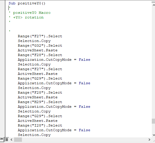

I just wanted to check to see if this is a known problem, or if my issue is more likely related to something different.

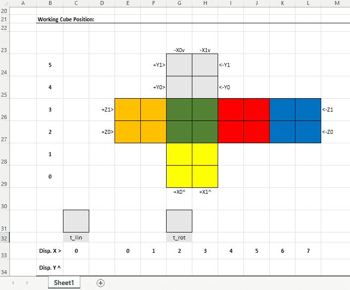

I have an Excel spreadsheet that has a number of lines with comments and other information at the top, and then a matrix of cells below that on several rows. I had some Excel macros working to exchange information between the cells in those rows, but after deleting a couple extra comment lines above those rows, the macros are doing some nutzoid things in terms of moving cells.
I expected that the macro cell references would have been adjusted just like normal Excel cell references are when you delete rows or columns, but so far it looks like that did not happen. This problem may have been caused by a strange laptop crash/OS update around the same time, so that's why I'm asking if Excel macros have a known issue. Figuring that out will help me to do a better job of going back to my last known good check-in of my file.
Thanks!
Hard to know without seeing the spreadsheet, @berkeman, but within-cell references do normally adjust for deletes, however named cells may not and macros that use absolute cell references won't cope either.
It's not unusual that deleting cells messes up formulas and/or macros. If a macro has a hard reference to A3, and a line at the top was deleted, then the macro does not refer to the correct cell anymore.

I can upload the *.xlsm file if needed, but usually we discourage the posting of files that can contain macros (let alone ones that explicitly contain them). I recorded the macros with copy/paste mouse clicks, so pretty generic cell references in the macros. I'll look through the updated macro files tomorrow to see if the differences are obvious after the file update. Thanks.
File name after changes:
"Rubiks Cube 2x2 Macros Simplified3 Only 2 Temp Variables 19-Aug-2022.xlsm"
Recorded macros are usually stored as absolute cell references. Those won't survive deleting rows or moving cells around.

Yikes, absolute references would be bad for edit updates. From using the Macro, Edit feature, so far they look like relative references...
Screenshot of a VBA macro in the Excel editor, a Sub named positiveY0 with a comment block, followed by Range selects, Selection.Copy, ActiveSheet.Paste and Application.CutCopyMode = False lines using cell addresses such as F27, G32, F28 and H29.
Just for full disclosure, this project is just for fun to code up a Python Rubik's Cube program to help me work on getting better at solving the 3x3 Cube. This is a simplified version of a 2x2 cube in Excel to help me figure out the best way to code the full GUI program in Python + Tk.
Excel spreadsheet grid showing an unfolded 2x2 cube net in coloured cells, with labels such as Working Cube Position, t_lin, t_rot, Disp. X > and Disp. Y ^ and axis labels including +Z1, +Z0, -Y1 and +X0^.

Those are hard absolute references. Note that "F27" won't change if you delete the top row.
In a regular formula it's a relative reference. But even absolute references in formulas will be automatically adjusted. Not in a macro though.
In a regular formula it's also a relative reference, but there it will be automatically adjusted. Not in a macro though.
Oh my. Thanks ILS. That would explain what happened. Time to revert back one revision and keep working from there (more carefully until I transition from the Excel experiments to the Python+Tk version.

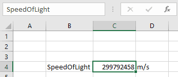

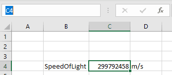

Let me provide a quick getting started guide to use named ranges.
In Excel we can do:
Excel worksheet with cell C4 selected in the Name Box; C4 holds 299792458 with the label SpeedOfLight in cell B4 and m/s to its right.
We can select the "C4" at the left top and change it into "SpeedOfLight".
Excel screenshot: Name Box shows SpeedOfLight for cell C4, which contains 299792458 with m/s beside it, and row 4 label SpeedOfLight in column B.
Now that cell is named "SpeedOfLight" we can use it in formulas like this:
