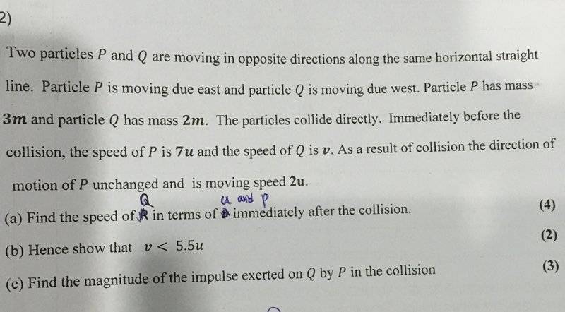

Two particles P and Q are moving in opposite directions along the same horizontal straight ine. Particle P is moving due east and particle Q is moving due west. Particle P has mass 3m and particle Q has mass 2m. The particles collide directly. Immediately before the collision, the speed of P is 7u and the speed of Q is v. As a result of collision the direction of motion of P unchanged and is moving speed 2u.
[/B]
Total momentum initial = Total momentum final
For any collision
Total Kinetic energy initial > total Kinetic energy final
[/B]
3m x 7u + 2m x v = 3m x 2u + 2m x ?
M canceled out from both sides
? = (15u - 2v)/2
This gives us the final velocity of Q in terms of u and v
Total KE initial = Total KE final
1/2 x 3m x (7u)^2 + 1/2 x 2m x v^2 = 1/2 x 3m x (2u)^2 + 1/2 x 2m x ((15u-2v)/2)^2
The halves and 3m cancels and we are left with(7u)^2 + v^2 = (2u)^2 + ((15u-2v)/2)^2
Now I'm stuck
I'm left with
49u^2 +v^2 = 4u^2 + (225u^2 - 60uv + 4v^2)/4
Please help

No I'm trying to prove that initial velocity of Q is < 5.5u
Try ##v = u## and see what you get.
Note: I think the question might be wrong.
PS or try ##v = 5u##.
Definitely wrong. I think I can see what the question should be.

No the question is right
May show a snapshot of the question?
Printed exam question 2 on two particles P and Q moving in opposite directions along a horizontal line, with parts (a) to (c) and handwritten annotations 'Q' and 'u and P' above the text.
  • Printed exam question 2 on two particles P and Q moving in opposite directions along a horizontal line, with parts (a) to (c) and handwritten annotations 'Q' and 'u and P' above the text.
Okay, sorry, I was taking ##v## as a velocity. And, it's got nothing to do with energy!
Do you want to completely rethink the problem? Or do you want another hint?

Think about the possible range of values for ##v_f##. Hint: The two objects can't pass through each other!
Opposite direction values?
PeroK said:
Another hint:
Why can't ##v_f =0##?
It says that both objects were moving
That's at the start. Maybe P hit Q and stopped it dead?
But it cannot cause the other particle kept moving
So unless P goes through Q, Q has to move move out of P's way cause P kept going in the same direction
Yes, but Q can't get out the way, can it?
So, after the collision Q has a minimum speed of ?
(15u-2v)/2
lioric said:
(15u-2v)/2
Okay, let me tell you. P is moving east at ##2u##, so Q must be moving east at ##\ge 2u##
That's all there was to it!
Ya so meaning that Q has to go faster than P
Understood
How am I going to prove that? I mean that V is < 5.5
Understood
just go to your momentum equation:
##v = 7.5u - v_f##
Understood
Is it by equating (15u-2v)/2 > 2u ?
Yes, but your reluctance to introduce the variable ##v_f## is going to hurt you in these sorts of problems. At this level, you need to introduce variables yourself without the question telling you which ones you need.
