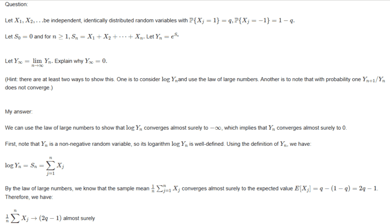

Let ##X_1, X_2, \dots ##be independent, identically distributed random variables with
##P{X_j = 1} = q, P{X_j = −1} = 1 − q.##
Let ##S_0 = 0 ##and for n ≥ 1, ##S_n = X_1 + X_2 + \dots + X_n.## Let ##Y_n = e^{S_n}##
Let ##Y_{\infty} = \lim\limits_{n\to\infty} Y_n.## Explain why ##Y_{\infty} = 0.## (Hint: there are at least two ways to show this. One is to consider ##\log{Y_n}## and use the law of large numbers. Another is to note that with probability one ##Y_{n+1}/Y_n## does not converge.)
My answer:
We can use the law of large numbers to show that ##\log Y_n## converges almost surely to ##-\infty##, which implies that ##Y_n## converges almost surely to 0.

Is the above answer correct?
Any reason it shouldn't be ?
Where's my magnifier ?
Please open images in new tabs and zoom them in 125% or larger than 125%. No need for magnifier.:smile:
DId just that and full is my screen with just the first few lines. But already doubt creeps in:
Any limitations on ##q## ? If not, for ##q=1## disaster looms ...
Or did my magnifier disrupt something ?

You need to address the issue that @BvU brought up in post #4. It's hard to prove something that is incorrect. When ##q=1##, ##S_n = n## and ##Y_n = e^n \rightarrow \infty##.
Likes WMDhamnekar
Sorry, I forgot to provide one additional information. For ##q =\displaystyle\frac{1}{e+1}, Y_n## is a martingale.
