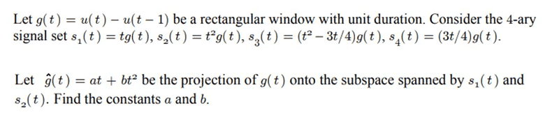

Hello everyone, I would like to get some help with the above problem on signals and linear projections. Is my approach reasonable? If it is incorrect, please help. Thanks!
My approach is that s3(t) ad s4(t) are both linear combinations of s1(t) and s2(t), so we need an orthonormal basis for the span of {s1(t), s2(t)}.
I normalize s1(t) to get u1(t) = sqrt(3)*t.
To get u2(t) I apply Gram-Schmidt by finding the projection of s2(t) onto u1(t), subtracting that result from s2(t) and then normalizing it. I got u2t) = 4*sqrt(5)*[t^2 - 3t/4]
So the projection of g(t) is g_hat(t) = r1*u1(t) + r2*u2(t), where r1 = <g(t), u1(t)> and r2 = <g(t), u2(t)>, the inner products. I get r1 = sqrt(3)/2 and r2 = -sqrt(5)/6
Putting it all together and simplifying, I get g_hat(t) = 4t - (10/3)*t^2, thus a = 4 and b = -10/3
Apologies for the formatting. Is this correct?

@ashah99, looks fine to me. It took me awhile to check all your work, but everything checks:
your orthonormal vectors are indeed orthogonal and have magnitude 1.
Calculating the inner product of g(t) with each of ##u_1## and ##u_2## gets you the magnitudes of the projection of g(t) onto each of these "vectors". Then scaling these unit "vectors" by the amounts you found from the inner products produces two "vectors" of the right length. Finally, adding these two together gets you the "vector" projection of g(t) onto the "plane" that ##u_1## and ##u_2## span.
Good job!

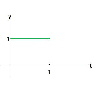

I don't have a background in digital communications, but I do know some math. I'm assuming that u(t) in your problem is the Heaviside unit step function, where u(t) = 1 for t >= 0, and u(t) = 0 for t < 0. u(t - 1) is just the same function that's been shifted to the right by 1 unit.
If so, then
##g(t) = u(t) - u(t - 1) = \begin{cases} 0 & t < 0 \\ 1 & 0 \le t < 1 \\ 0 & t > 1\end{cases}##
So in a nutshell ##s_1(t), s_2(t), s_3(t),## and ##s_4(t)## just multiply ##t, t^2,## etc. by 1 for t between 0 and 1, and 0 elsewhere.
Here's a graph of y = g(t), based on my assumption:
