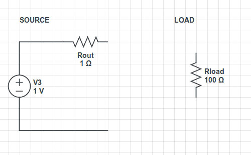

A source and load can be modeled like this: (The model of the source is called the Thevanin equivalent circuit fyi.)
Do you notice the output resistance of the source (Rs)? When current flows there is going to be a voltage drop across Rs. If your load is 100Ohm then by the voltage divider rule that drop won't be significant.
Now imagine what would happen if the resistors were flipped so that the output resistance of the source (Rs) is 100 and the load input (Rload) is 1 Ohm. Now most of the voltage drop will be across the output resistance and you won't get much voltage on the load.
Some sources are going to have high output resistance. Sensors are a good example. Some loads are going to have low input resistance.
The simple op amp follower allows you to connect the source to something with high input resistance. It could be in the MOhms range. That way the majority of the voltage is delivered to the amp by the voltage divider rule. The ouput of the amp will match the input and also have a low ouput resitance so you can deliver more current to the load without a voltage drop.

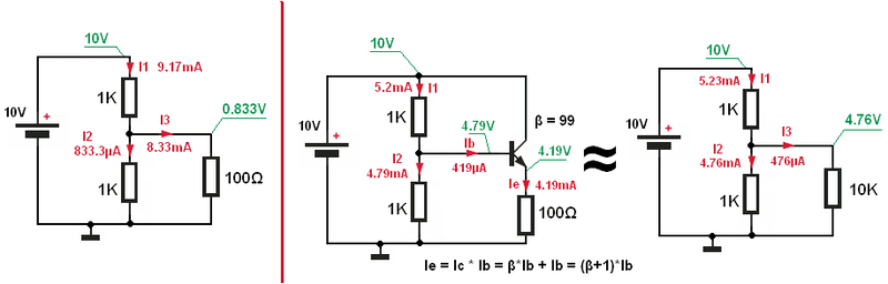

Suppose we have a 1K resistor voltage divider supply from 10V battery.
Without any load connect to the output terminal of our circuit output voltage is equal 5V.
Now we connect a 100Ω load resistor across the output terminal.
And now our voltage divider output voltage drops from 5V to 0.83V. So we ruin our circuit.
To fix this issue we add a buffer (emitter follower) see the diagram
