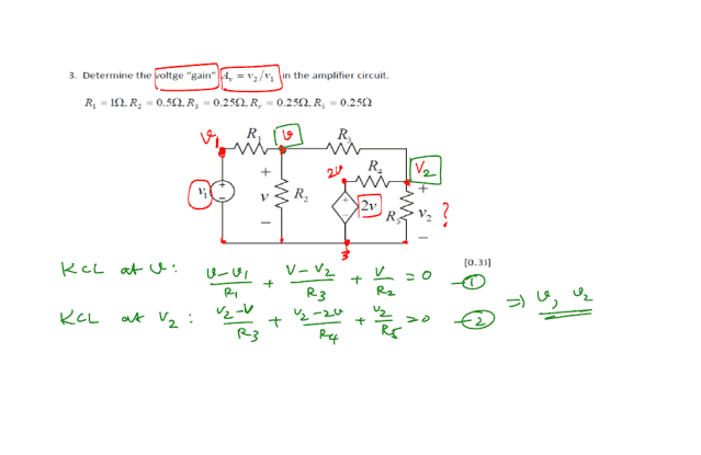

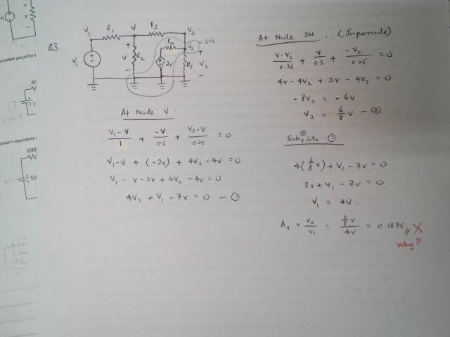

I don't understand why my solution is wrong. I was taught that if I were to use Node Voltage analysis, I should put nodes with voltage sources into supernodes which was what I did, however, my teacher showed a rough guide in class and he did not use supernode.
Hence, I am a bit confused now -- when do we use supernodes and if we use supernodes, how big should they be? For the question above, if I were to use supernode, assuming I made some calculation errors above, will I get the same answer as my teacher? Thanks!
My teacher's partial solution:

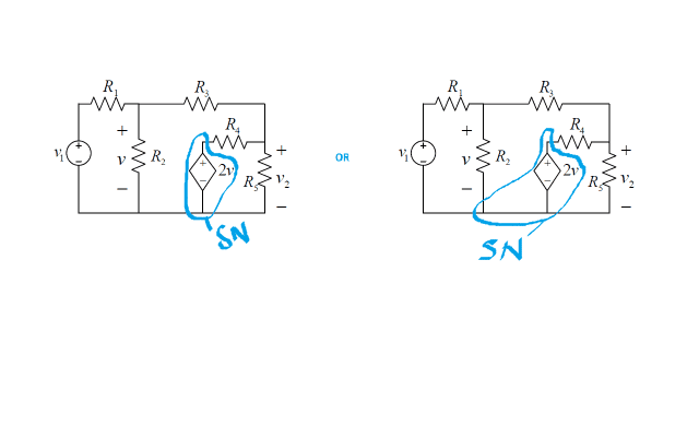

I see. So that means I cannot put a supernode at the dependent voltage source, because I will not be able to loop it after and around R4, which makes it look funny, and hence I should not do it. Am I right to say this? I attempted to draw a supernode below, according to what you have said above, to be sure I did not interpret your message wrongly. :)

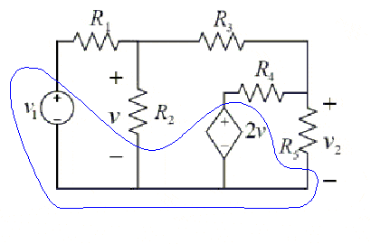

The reference node and the directly attached sources can be considered a supernode.
The potential at the top of v1 is, well, v1. And the potential at the top of the 2v source is 2v. These are fixed potentials with respect to the reference node as set by those sources.
I see. Thank you for the illustration. :) I shall try solving the question again.

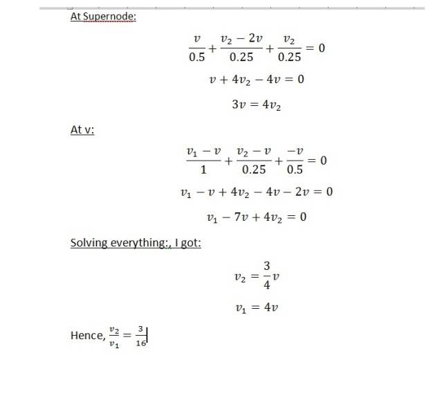

Here is my working: (I was typing out when you posted this. Haha.)
Thanks! :D

Your "supernode" equation is not correct; it has no term for the path through v1 and R1.
But your supernode includes the reference node, so you do not have to write an equation for it. The second node to use is where R3, R4, and R5 come together (that is, v2).
Oh gosh! @.@ Sorry. I made a careless mistake there. :( I have to add (v-v1)/1 in front of the first equation under SN.
And hmm.. I shouldn't have written an equation for v cos it overlaps with my equation for the supernode..
I finally got the answer~ Thank you very much! ^^
