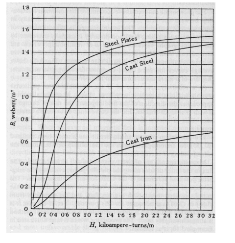

I'm just trying to get my head around electromagnetics for the first time, and need help understanding a question that asks:
"Using BH curves find the maximum permeability of the cast iron forming the magnetic path."
Now from wikipedia I know that the permeability of cast iron should be around 0.25H/m.
What I don't understand is how to get this quantity from a B-H curve like this one:
http://imgur.com/eiv6IuN
Now what I do understand is that permeability is given by B/H essentially. That would imply it is the gradient of these lines.
So to find the maximum permeability all we need to d is find the point with the most positive gradient.
Is this logical correct?
It depends on what permeability you have in mind.
For small perturbations about an operating point H, the slope of the B-H curve is the permeability. In other words, dB/dH. It would be called dynamic permeability.
But one can also talk of static permeability. To get it, you again pick your operating point H along the B-H curve but now permeability is simply B/H.
In both cases the hysteresis curves show that the B corresponding to your picked H depends on the history of applied H.

The image referred to by Learnphysics ...
Thanks Nascent. As i suspected, those are not hysteresis curves, avoiding the ambiguity I referred to as 'history'.
so my first comment applies except ignore the bit about history.
