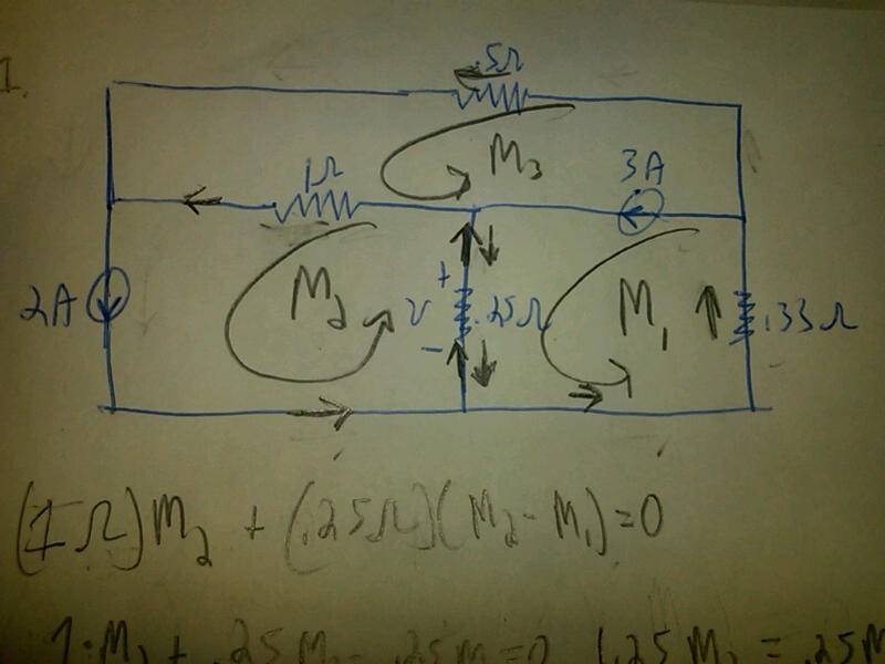

Please see the attached file for the problem statement. I am attempting to find the current across the .25 Ohm resistor.
Using kirchhoffs voltage law I write the following equations:
(1 Ohm)(2 amps) + (.25 Ohm)(2 - M1) = 0
Solving this equation for M1, I get that the current through the .25 Ohm resistor is 10 Amps, but I do not believe this to be correct.
Can someone please explain to me where I am going wrong?

The 1 Ω resistor is in two loops. Also, current sources may have a voltage across them.
You have only current sources, so it might be easier to write node voltage equations rather than mesh current equations.
Thanks for your replies, mesh analysis is mandated for this problem. If i annotate my solution such that the 1 ohm resistor has the differences of the two currents crossing it rather then just the single current, is the remainder of my analysis and procedure accurate?
The proof is in the pudding, as they say. Do you get correct results from your analysis?

As I already wrote, current sources may have a voltage across them. So to apply Kirchoffs voltage law properly there you must include the current sources's voltage in the sum of all the voltages in that loop.

Mesh equations with voltage sources can be speedily written in matrix form using a simple shortcut method that requires almost no thought. Mesh equations with current sources requires you to introduce more variables for the voltages across those current sources, and write additional equations relating the mesh currents to the constraints of the sources. I'm not aware of any simple method of translating that directly to the minimal equation set (one per mesh).

They either greatly simplify the problem by allowing you to solve the mesh current by inspection, or it results in a simple super-mesh.
Writing the equation for a super-mesh is no more difficult than writing an equation for a regular mesh(or it shouldn't be), you just have to pay attention to which mesh current is flowing where.
For this problem, one can solve the mesh current in M2 by inspection.
Write one mesh equation for M2(or better yet a simple KCL), one super-mesh equation and you're done.

If there are three loops, create a 3 x 3 matrix. Write the sum of the loop impedances on the diagonal entries, write the negative of the impedances that straddle loops in the off-diagonal entries, and stick the sum of the loop voltage sources into a separate vector. Throw the lot at a solver and out pops the results for the loop currents. Done and dusted. Almost no thinking required!
