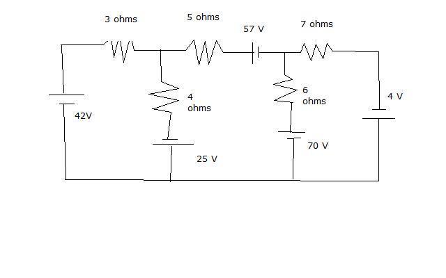

Use mesh analysis to find the current through the 4 Ohm resistor.
From this circuit I managed to work out the three mesh equations using mesh analysis.
Mesh 1 = 7I1 + 4I2 = 67
Mesh 2 = -4I1 + 15I2 - 6I3 = 152
Mesh 3 = -6I2 + 13I3 = 74
Are these mesh equations correct.
From this point in the question how do I calculate the current through the 4 ohm resistor. I know you use simultaneous equations but I can't get the correct answer. Please help.

Your equations are a little bit off. I get:
7 I1 - 4 I2 + 0 I3 = 67
-4 I1 + 15 I2 - 6 I3 = -152
0 I1 - 6 I2 + 13 I3 = 74
Don't forget that the current in R4 is not just one of these currents; it's I1 - I2.
Do these equations give you the correct result? Do you see where you went wrong?
the correct equation is :
7 I1 - 4 I2 = 67
- 6 I2 + 13 I3 = 74
7 I1 - 4 I2 = 67
- 6 I2 + 13 I3 = 74
Use matrix to find the value of I1,I2 and I3 then u find he value of current in 4 ohm is
4I1-4I2=IR4
