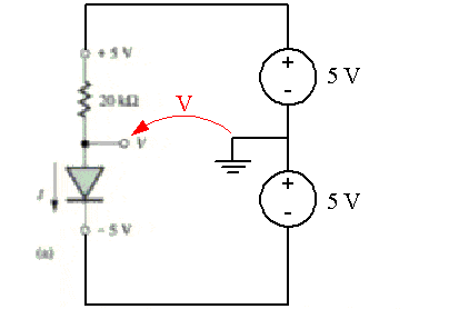

First question,
In the picture attached (One diode and Resistor), when you are calculating V, is the V drop across the diode or the resistor?

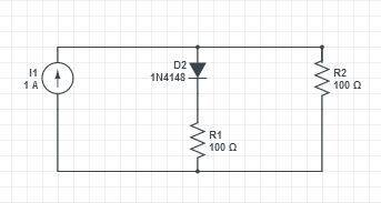

In the second picture (circuit with current source) Why is the nodal analysis equation,
1A=V/100ohms + (V-0.7)/100ohms
Forward voltage drop = 0.7, V is voltage at the node in the middle.
The part I don't get is the (V-0.7)/100ohms, why are we taking the voltage across the diode then dividing by the resistor? Shouldn't it be voltage across both the diode and the resistor?

Neither, really. It's the potential at the terminal with respect to the circuit's reference node. In this case the reference node is implied and not shown explicitly. Note that there are two voltage sources, +5 V and - 5 V, which are indicated. These have an implied common reference point. If you want you can sketch in the voltage sources and the common reference to make it clear:

For nodal analysis the idea is to treat a series branch as a whole and find the net potential difference across the resistive part and divide by that resistance to determine the current. The diode drop, if the diode is forward biased, can be treated as a voltages source of 0.7 V. That makes the voltage drop across the resistor V - 0.7.
So the resistor does not have to be in the middle of potential difference you are trying to measure? and the equation really is V-0.7-0/100ohms ?
You can rearrange the order of the components in a series circuit (a branch) any way at all and won't change the result. After all, the potential changes are summed, and it doesn't matter in what order a sum is performed.
Yes, that really is the equation :smile:
