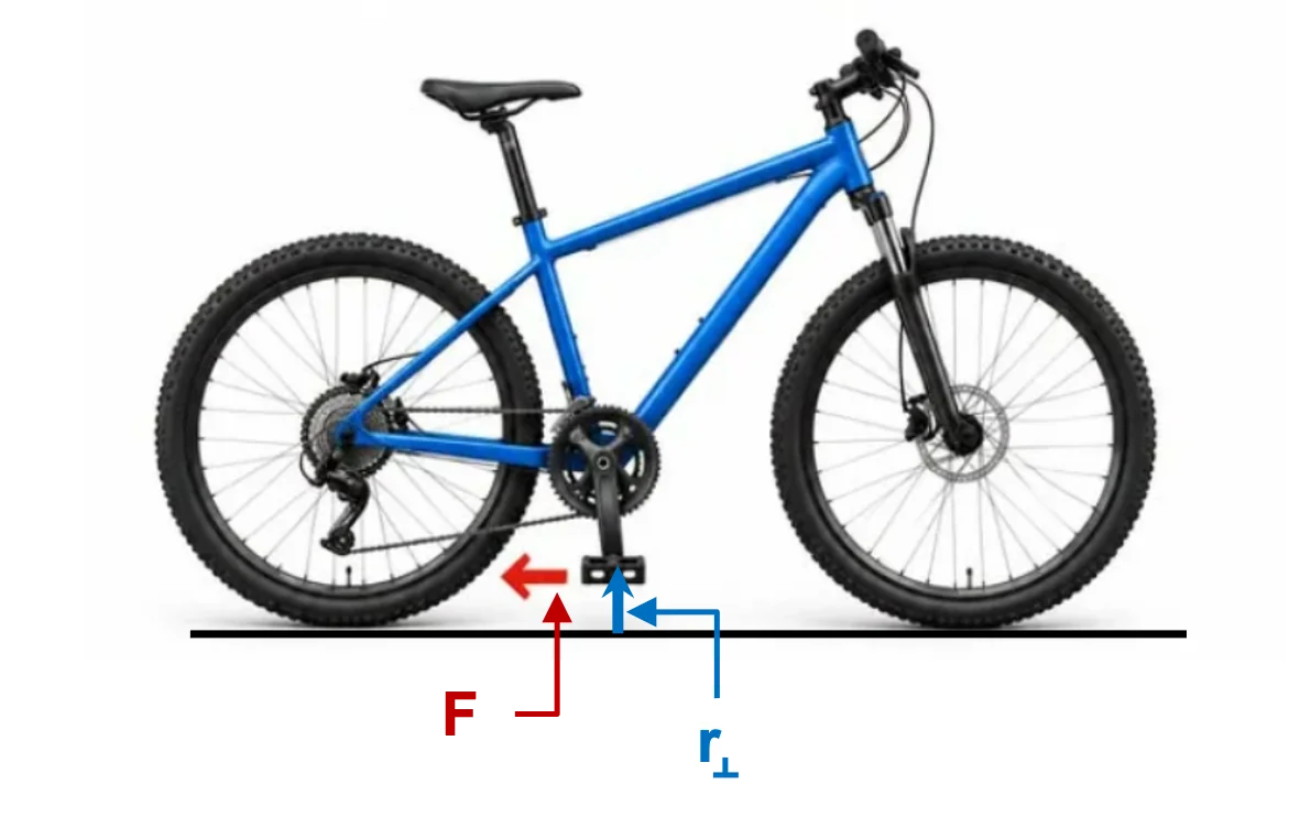

It's a simple application of Newton's Second Law.
(a) If the bicycle rolls without slipping, the IPOC (Instantaneous Point Of Contact) of the wheels and the floor is at rest regardless of which way the bicycle moves.
(b) Tie a piece of string on either pedal and pull standing behind the bike with force ##\mathbf F## as shown in the modified figure from post #1.
The bicycle will accelerate to the left according to Newton's Second Law for translational motion. The wheels will acquire counterclockwise angular acceleration according to Newton's Second Law for rotations due to the counterclockwise torque ##\tau=Fr_{\perp}## relative to the IPOC.
People who believe that it is possible for the bicycle to accelerate forward, must also believe that "you can push with a rope." :rolleyes:

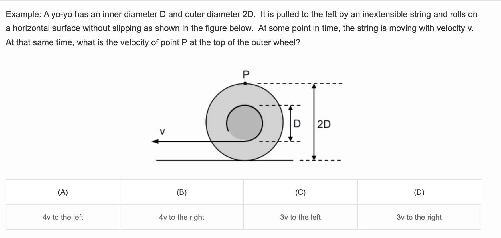

Bonus question for the spool "paradox" enthusiasts. It is a screenshot from my insight post.
(A) 4v to the left
Newton's Second Law is:
Fnet = ma where Fnet is the sum of all forces.
You have failed to include the forward force of static friction by the ground on the back tire, that will be there if you apply a force to the pedal like that. So you have two opposed forces, and the gearing determines which one is greater.
No. They are simply people who understand Newton's Second Law and mechanical advantage. You should have watched the video in post #3 at 2:30 before posting:

I just looked at this. We have a force of magnitude ##F_1## applied to the left (backwards). This, through the gearing mechanism, also produces a clockwise torque on the back wheel of ##\tau_1 = rF_1##, where ##r## is a gearing factor, with dimension of length.
The friction between the back tyre and the surface creates a second force of magnitude ##F_2## to the right (forwards). This force is variable (up to the maximum possible by static friction). This force produces an anti-clockwise torque of ##\tau_2 = F_2R## on the back wheel, where ##R## is the radius of the back wheel.
Given we have rolling without slipping, we can calculate ##F_2## in terms of the other quantities, where ##M## is the mass of the bicycle and ##I## is the moment of inertia of the back wheel. This gives:$$F_2 = \bigg [ \frac{I +mrR}{I + mR^2} \bigg ]F_1$$The direction of motion, therefore. depends on the relationship between ##r## and ##R##.
If ##R > r##, then ##F_2 < F_1## and the bicycle moves backwards.
If ##R < r##, then ##F_2 > F_1## and the bicycle moves forwards.
Let me give you a gift in return.

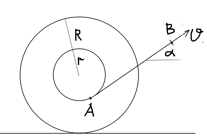

A rigid body consists of two coaxial spools of radii ##r## and ##R,\quad R>r.## The outer spool can roll on the plane without slipping. A string is wound around the inner spool and pulled by end ##B## with a velocity of constant magnitude ##v## and directed along the straight portion ##AB## of the string. It is known that at the initial moment, the angle of inclination of the straight portion of the string is equal to ##\hat\alpha\in (0,\pi/2)## and ##AB=\ell##. Find the dependence of the length ##AB## on ##\alpha## in the subsequent motion. ##r\ne R\cos\hat\alpha.##

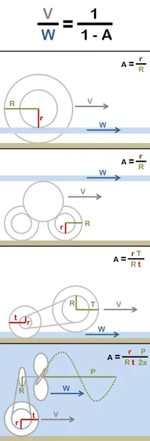

You got it right, but you could have made your life easier by defining just one parameter for the mechanical advantage of the bike: ##A = \frac{r}{R}## (where ##r## & ##R## are your two parameters), and arrive at the formula in the diagram below leading to the same conclusions, without any use of forces or inertial parameters.
