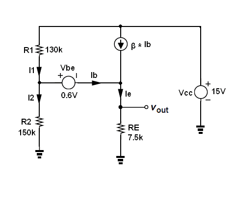

Your answer is not correct. You forget about 150K resistor.
Maybe this circuit will be easy for you to solve, you can even use nodal analysis.
Also notice that I1 = (Ib + I2)
Or you can replace voltage divider with his thevenin equivalent circuit.

Here is a revised version of the solving for VB using KVL
This is question 2(a).
Thank you for any help that you can offer.
Did I answer the question correctly and thoroughly? Can you please find any errors, and point them out to me so that I can fix them?
2(a): Calculate VB including loading of the bias network by the BJT

VCC-(IB)(RB) -(IE)(RE)-(VBE) = 0
https://scontent-b.xx.fbcdn.net/hphotos-frc1/t1.0-9/1964876_10151943479145919_1107480603_n.jpg
Is the answer correct for V(B)? If not, where are the errors located?
Thanks again for your help.

You have error already in the the second expression. Are you sure that this is correct KVL/KCL for this circuit? Can you tell me where do you see RB resistor in this circuit ?
The KCL for VB node is I1 = I2 + Ib
Or why you don't try to use thevenin's theorem and replace R1 and R2 and Vcc with his equivalent circuit (Rth and Eth)?

Could Rb= Rb1||Rb2?

How many loops do you have with KVL?
Two loops:
First loop
Vcc = I1*R1 + I2*R2
And the second one
I2*R2 = ??
Or we can use nodal equation
(15V - Vb)/130k = Vb/150k + Ib
Where Ib = ??

Could Rb= Rb1||Rb2?
Yes, but what about Vcc ?

I don't understand,
Wouldn't it be :
Vcc - Ib(R1||R2) - IeRe - Vbe = 0

No this is incorrect because Ib current flows only through R1 resistor.
But we can use Rb = R1||R2 if you replace R1 and R2 voltage divider with his thevenin's equivalent circuit.

you please just tell me the KVL for this circuit again. I cannot obtain an official answer anywhere. I've been working on this problem for four days and it's only worth two points. I don't get it, and I need it to be laid out without anymore theory, on math.
You've been a big help. Could you show me both of the KVLs for this circuit
