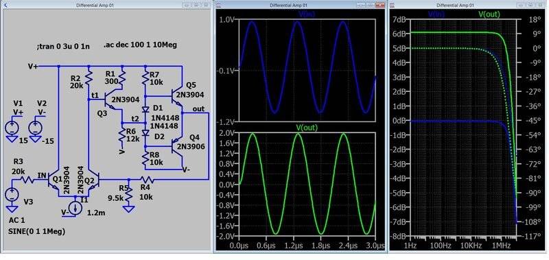

  • #32
I'm interested in revisiting the incomprehensible circuit mentioned at the beginning of this thread. As I mentioned before, if you apply a proper bias voltage, you can make the base voltages of the two transistors very close, as shown below.
This differential amplifier has high input impedance over a wide frequency range because the impedance of the current source is infinite.
On the other hand, it can be seen that its output (Q2 Base) remains very close to the input over a wide voltage range up to 100 MHz, although the DC level is slightly shifted and the amplitude is reduced. But unfortunately in the end this electronic circuit is still meaningless and cannot be called a follower because its transistor base output impedance is surprisingly high. :frown:

  • #35

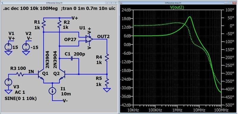

When I remove two resistors, and reduce the bias current from 60 mA to 5 mA, I get;

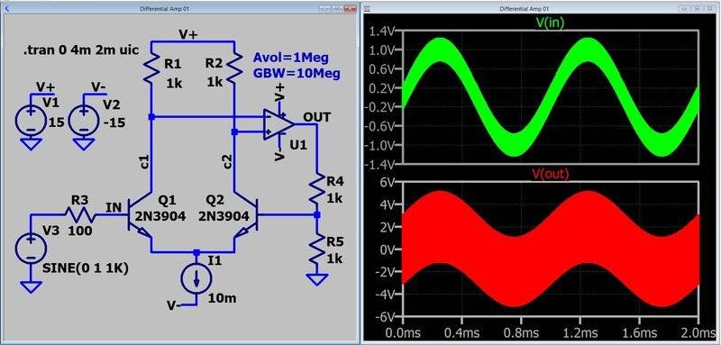

  • #39
LvW said:
I have mentioned already one restriction: Due to active feedback (feedback factor can be above unity) the differential gain of Baluncore`s circuit (post#22) must not be too low (a gain of two leads to instability).
This circuit is basically a very good design. But just like a general negative feedback circuit, it does enter an unstable state in some special cases. But this does not necessarily mean that there is a problem with the basic structure of the circuit itself, usually the problem can be solved by simply modifying the parameters
For example, as shown in the figure below
Just change the GBW of the op amp from 10Meg to 1Meg or reduce the negative feedback factor (R5 from 1K to 300) to eliminate self-oscillation and resume normal operation without reducing the voltage gain.

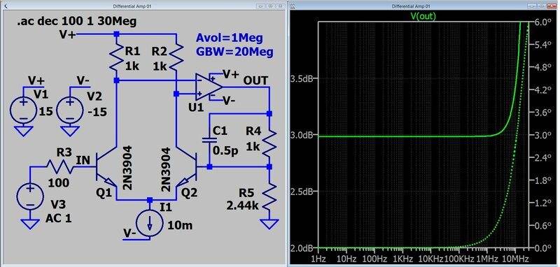

  • #40
With a slight modification again, we can make this circuit have the following nice properties (At least it looks like this in the simulation).
The input impedance is close to infinity, and the output impedance of the op amp is very low
Operating frequency from DC to 10MHz. In this frequency range, the input and output are almost completely in phase. Absolutely stable, no self-oscillation occurs.
The voltage gain is set to 3db, which can be lower than 2. In fact, the voltage gain can be set arbitrarily, etc. :smile:

What is U1 op-amp, generic ?
Beware SPICE AC analysis. Instability is always possible, as AC gain plot does not show phase to infinity, you must check the time domain.
Why do you not show to beyond 1 GHz? You have a high pass filter in the loop. The rising graph looks to me like it might oscillate in the UHF band, before the gain falls off.
  • #42
I just took this op amp from the parts library inside the LTSpice.
Description : A linear, single pole op amp with no internal nodes or input voltage range limits.

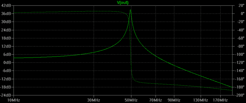

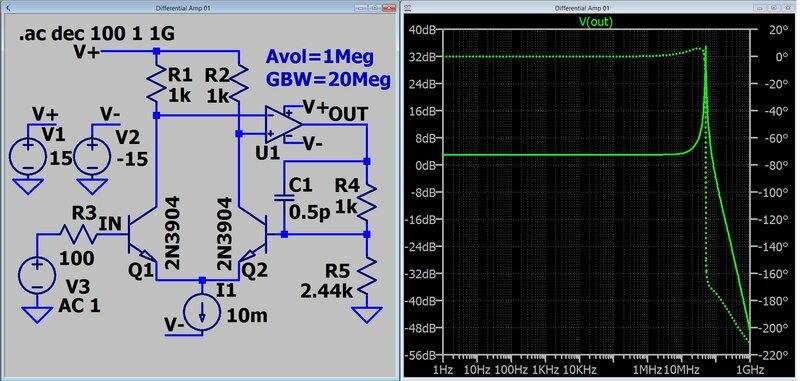

I checked the time domain and found no parasitic oscillations. But I'll still try to dig deeper into this.
Agree, this is a matter of concern.
The following is the simulation results from 1Hz to 1GHz.
  • Wow
  • #43
I get a similar result.

@alan123hk
It seems that the 39 dB gain at 50 MHz is an artefact of the universal op-amp model. The circuit will be better behaved if you substitute something real, like an OP27 or OP37. The OP07 is too slow and accurate.
  • #45
I found that while using the OP07 or OP27 reduces the overshoot of the frequency response curve, there is some parasitic oscillations in the output.
I believe these unwanted oscillations can also be removed with some modifications, but it seems the problem is more difficult than last time and may take longer to find a solution.

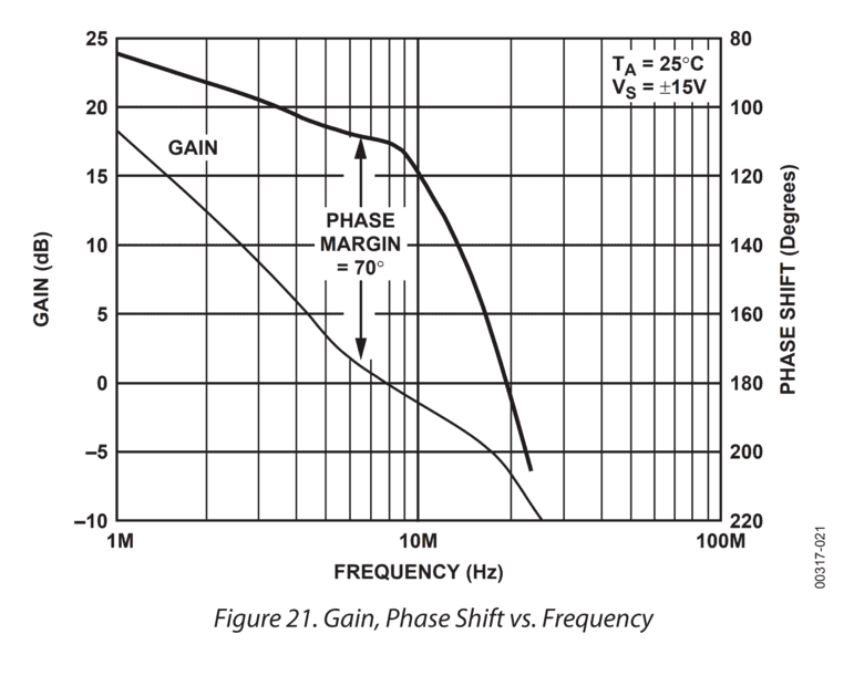

  • #46
Alan123hk, I agree to all of your conclusions (post#39, 40 42, and 45). The circuit works when we carefully take the stabiliity criterion into consideration. There is no fundamental problem.
However, we must remember what happens when we have ACTIVE feedback (feedback factor>1).
In this case, the "critical point" with unity loop gain is located at a frequency which is LARGER than the opamps transit frequency.
Therefore, it is of great importance how the opamps open-loop gain response looks like for such high frequencies (above the transit frequency). That is the reason the various opamp models behave so differently. This applies in particular for simple opamp models with only one single pole - these models cannot reveal the real behaviour of Baluncore`s circut.
There are two basic methods to overcome the mentioned stability problems:
(1) Application of one of the known methods for external frequency compensation
(2) Restriction to larger closed-loop gains (certainly larger than "2") which means: (a) Reduction of the opamps resistive feedback factor or (b) gain reduction of the transistor amplifier.
The degree of the necessary actions (case a or b) depends on the opamp used (and, in particular, on its phase shift function for frequencies above the transit frequency).

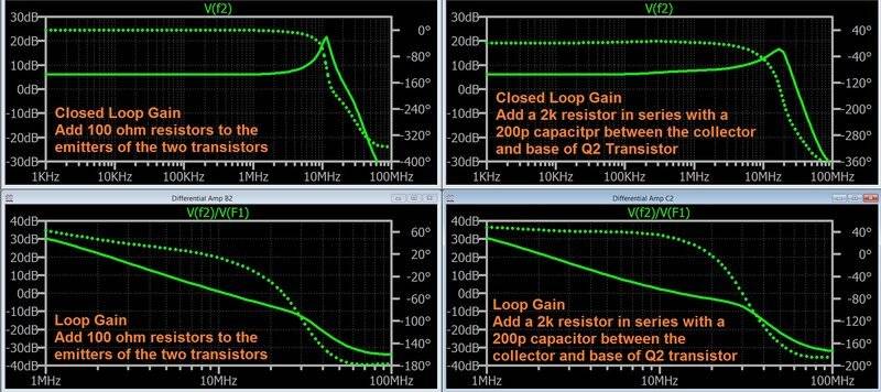

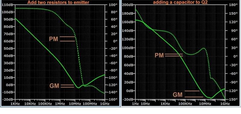

  • #51
To complete my analysis of the circuit under discussion here are my simulation results:
* Baluncore`s circuit (post#22) with all values as given in the figure.
* Opamp modell (PSpice) LT1022/LT
* Transistors BC549
* Loop gain analysis indicates instability up to a closed-loop gain of at least Acl=50 (34dB).
That means: Stable for closed-loop gains above 34 dB only.
(Note: To verify instability in the time domain we must check "skip initial transient solution" or switch on (at least one of the) power supplies at t=0).
* The circuit was stabilized lowering the gain of the long-tailed pair using negative feedback with two additional resistors (100 ohms) between the emitter nodes and the current source (still 10mA).
* Now the circuit works stable down to a closed-loop gain of app. Acl=4 (12 dB, stability limit, opamp feedback resistors 1k, 0.250 k). That means: Stable for closed-loop gains > 12dB.
* Similar results for OP-27/LT

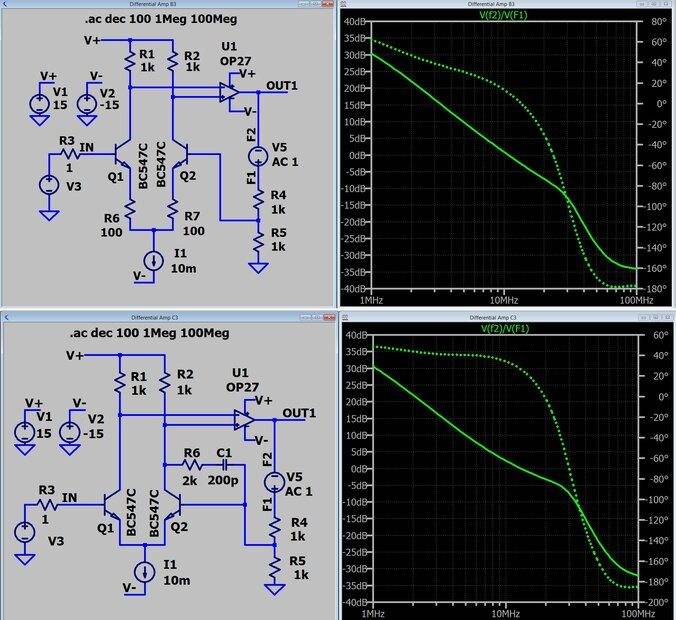

  • #52
@LvW
Your approach of adding two resistors to the emitter is perfectly fine.
I think of another method as shown in the figure below, adding a capacitor between the collector and base of Q2. Although the bandwidth and stability of my method are slightly worse than yours, it still seems to be able to keep the circuit in a stable working state.
It would be interesting to try to compare the stability of the two approaches.
  • #53
Ala123hk - I am sorry but I cannot confirm your findings.
Perhaps you have used another OP-27 model?
I have used OP-27/LT (but similar results for OP-27/AD ) with two 1k feedback resistors.
How did you simulate the loop gain?
I have used an ac source between the opamp output and the first resistor (in your diagram R4).
My results:
* With two 100 ohms in the emitter legs: PM=-10 deg and GM=-3dB
* With C1=200pF (without the 100 ohm resistors): GM=-40dB (PM not applicable because the phase crosses the 0 deg-line twice).
Most remarkable: In my simulation, the loop gain settles app. at -60dB above 100 MHz (in your simulation it goes down to max. -20dB and rises again).
EDIT: OK - using a simple model called OP-27 my results are very close to yours.
This is another proof that modelling of the 2nd and 3rd pole is very important in the case under discussion.
I just pulled this OP27 from the parts library provided by LTSpice. I don't know how complex its internal structure is, like how many poles it has etc. If you mean it's a simple OP27 model, where can I find better or more sophisticated OP27 models?

As mentioned already in an earlier post - one must be very careful when interpreting simulation results.
Simple example: Universal opamp model with inadvertently added positive resistive feedback. All simulations (ac, dc, TRAN) will not reveal instability.
Error of the simulation program? No ! The program is not responsible - it has worked properly.
The user is the source of errror. He did not know that such a system can be stable (theoretically!) because there is absolutely no external disturbance.

Sorry, I found the stability analysis Bode plot I uploaded a little bit inaccurate. Below are the corrected results that I think should be accurate enough.
It can be seen that the results obtained by the two methods of improving stability are almost the same.
Both have a flat bandwidth of about 5 MHz and good stability.

Hi Alan,
in order to interprete your results it is important to know which circuit you have simulated - the circuit in post#52?
Which opamp model?
Which kind of correction?
  • #60
Which opamp model? Which kind of correction? How did you simulate the loop gain?
Of course, I just use the OP27 model provided by the parts library of the LTSPice, because it is very convenient.
For my suggestion to improve stability, the correction I said is to first change the single capacitor into a resistor and a capacitor in series, place it between the collector and base of the transistor Q2, and then move the injection voltage from the previous position to the output of op amp U1.
The image below says it all.
By the way, unfortunately for amateur electronics enthusiasts like me, due to limited resources, we can only do a simple loop gain simulation analysis of the linearization circuit using free software.
But for the laboratories of large companies and universities with deep pockets, in addition to computer simulations, they also have very advanced instruments to perform this analysis on real circuits.
