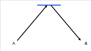

Imagine Alice turn on her torch toward a mirror (blue). Alice will see herself stationary.
And imagine what Bob ( who is stationary according to Bob), sees Alice's (who is moving according to Bog) light?
The path of light from Bob's view takes longer than what Alice views. So Bob will see Alice's time slowing down.
