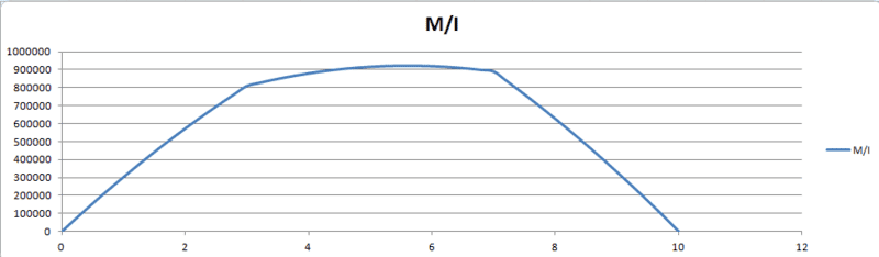

thanks. Please can you explain what the M/I diagram is?
Just what it says. Take the ordinates of your bending moment diagram and divide by the moment of inertia of the beam (in this case I = 150 * 10^-6 m^4 according to the OP). It's not really required for this problem, since I is a constant, but when I changes along the length of the beam, an M/I diagram is useful when calculating deflection.

so would the diagram be as pictured?
Looks OK. Make sure you use the proper units.

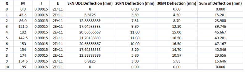

I have got the following answers for total deflection. do these look feasible?

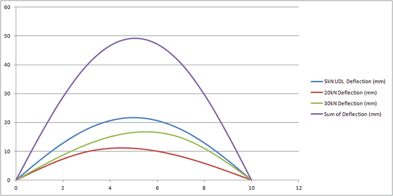

ok got it. here are my answers for the deflection.
and the graph looks like this
does this look reasonable? Would the 5kN UDL really cause more of a deflection that the 30kN point load?
