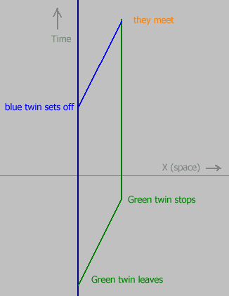

Next thing i do not completely understand is the twins paradox. One twin travels in a spaceship with a speed near the speed of light and his clock is ticking slower relative to his brother's clock, so he will become younger than his brother. But in order to check whether he is younger than his brother, he must stop and wait for his brother to arrive. While he waits and the brother is travelling, his clock will tick faster relative to the brother's clock. So when they finally meet, they will discover that they are still of the same age and their clocks show the same time. Is this correct or not?
You are correct, if the journey of each twin is identical. It's clear from the symmetry of the diagram that the twins have equal proper time. If either spoils the symmetry, they will have different ages. It is also clear that it does not matter when the blue twin decides to leave, as long as the diagram is a parallelogram both trajectories have equal proper time.
Mentz114's answer is technically correct, but it is NOT what is usually meant by the twin's paradox. In the usual formulation of the twin's paradox one twin is inertial the whole time and the other is non-inertial. The non-inertial twin is always younger.
So, for example, a traditional twin's paradox scenario like what Tantalos described might go something like this: In some inertial reference frame the inertial twin travels at .6c for 5 y, a total distance of 3 ly, meanwhile the non-inertial twin travels at .75c for 4 y and then stops for 1 y. If you work out the math you will find that the non-inertial twin is younger.
Mentz114's answer is technically correct, ...
I thought it was a completely correct answer to the question. He wasn't asking about the 'traditional' twin scenario.:smile:
I read his question differently. I read it as asking about the traditional twin's scenario in the reference frame where the traveling twin is at rest on the final leg.
But physical laws should be independent of reference frames. Then we should get the same result independent of speed of reference frame of the second twin. But I think we get diffrent results, because we did not take into account length contraction. The observer on Earth will experience not only time dilatation but also length contraction of the paths the twins travel, Although to the Earth observer they will appear at the same place after five years, they actually will not be at the same place due to length contraction. The twin that travels at 0.75c will be further away because his path was more contracted.
Physical laws are independent of inertial reference frames. You can see physical laws taking different forms in accelerated reference frames (e.g. the Coriolis force arises due to rotation - there is no such force in inertial reference frames).
The Lorentz equations were derived assuming constant speed v of reference frame. We cannot use this formula to discontinues cases were objects change speed as the twin first travels at 0.75c and then stops and waits.
Go ahead and work it out. You will see that we do indeed get the same result in any inertial reference frame.
