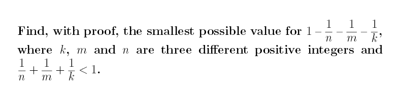

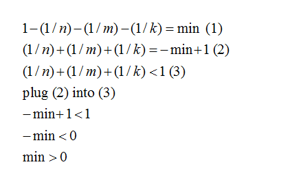

Here is one attempt
But I'm stuck on this inequality. I can't go further.

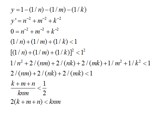

and here is another, but I don't know if I proved anything here.
Really looking if anyone could help me on this or if I'm on the right track. Thanks.
There are two components to the problem; (1) find a candidate for the solution and (2) prove that candidate is the right one.
For (1) I recommend throwing away all this fancy schmancy algebra and calculus and just roll up your sleeves and try a few things. Also, recognizing that your problem is equivalent to maximizing ##\frac{1}{n}+\frac{1}{m}+\frac{1}{k}## subject to ##n,m,k## distinct and ##\frac{1}{n}+\frac{1}{m}+\frac{1}{k}<1## might make some of this work a little more manageable.
Once you've found a triplet that works, try to prove that it's the best triplet. Don't get fancy, just think about it. If need be, find other triplets that work (in the sense that ##n,m,k## are distinct and ##\frac{1}{n}+\frac{1}{m}+\frac{1}{k}<1##) and try to see why your triplet is better.

No, you are on the wrong track: you cannot take derivatives with respect to discrete (integer-valued) variables like n, m and k. Derivatives need continuous variables, and you don't have those in this problem.
And even if m, n, and k were continuous variables, you certainly cannot take the derivative with respect to three different variables as you did here.
Thanks for pointing that out because I just remembered that it would be an implicit differentiation if I did take the derivative and I did not do that.
recognizing that your problem is equivalent to maximizing 1/n+1/m+1/k
Thanks for the hint, but I don't quite understand it. I thought I was trying to minimize it not maximize it.
In this case if you maximize 1/n+1/m+1/k (while still being smaller than 1) you minimize your goal function, right?
Thank you dirkmec1 I now understand!
