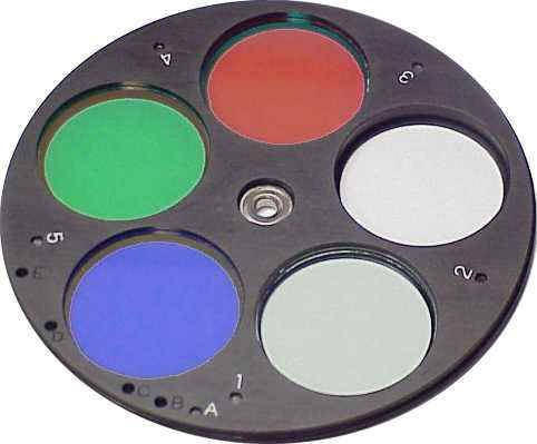

As mentioned, unless you work for Apple in iPhone development (or at one of their competitors), this is not something you will likely be able to do. And the cell phone makers would need some compelling business case to justify the extra cost of adding this new feature into their phones.
Something a bit more useful would be an IR LED transmitter that you can power from your phone's USB port that you use along with your phone's camera to be able to see in the dark (for moving around a dark house, for example, and not waking up your spouse with a light). It would likely use less power than the torch.
Or, if you are adamant that you want to be able to change the color of your phone's torch, just make a small version of this and stick it onto the back of your phone over the torch output...
http://www.company7.com/optec/graphics/ifw_wheel.jpg

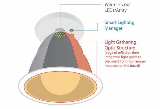

You might be able to buy a USB powered colour changing light.
Drakkith said:
Only if the LED can emit multiple colors. But I don't know of any that can.
LED can do that .
psnkeras said:
LED can do that .
WHAT led can do that? Be specific
There are bi-color and tri-color LEDs, and there are "white tuning" circuits that can drive them to different areas of the color spectrum. I've worked with them on a recent LED lighting project at work. Some small bi/tri-color LEDs have the separate die in the same LED package, but for higher powers, they will generally be tight LED arrays on a common heat sink:
https://eenews.cdnartwhere.eu/sites...files/images/amscontrib3530.jpg?itok=tC_r-Gzj
Cool. Hadn't heard of those. Thanks.
psnkeras said:
LED can do that .
Then there's no issue.
