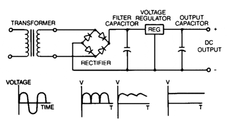

If the voltage levels can work out, one common way to fix this is to follow your transformer, full-wave rectifier and smoothing caps with a low dropout linear voltage regulator. You need the minimum voltage input to the regulator (the troughs of the input ripple voltage) to stay above the dropout voltage of the linear regulator (hence why you use a low dropout regulator). If the troughs of the input voltage across the capacitors at full output current loading is 23.5V, you could probably manage about a 22.5V output voltage from your adjustable low dropout linear voltage regulator, and it should be nice and quiet.
Thanks for the reply.
So would we be looking at a lower output voltage than 24V if I implemented smoothing? I may get away with a small drop, but a couple of volts may not be feasible.

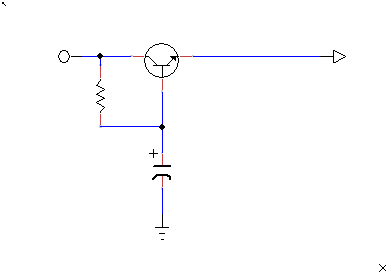

and speaking of ALL the circuit, it's probably way past time you showed us ALL of it, specially after comments like this ...
If we knew what your circuit looked like, type of sensor etc ... better suggestions could be made to help youDave
JaredJames said:
Your sketch shows 24V shorted to GND in two places...

That's why you use a low dropout linear regulator -- to minimize the voltage drop. You should be able to get away with about 0.5V drop at your low currents, but check the datasheet for whatever part you choose to see what the dropout voltage is.

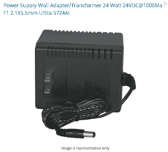

Switching power supplies are inherently noisy. They make RFI at switching frequency that shows up as 'ripple' .
For your light load you might look for a "Wall Wart" transformer based linear supply. Linears are electrically much more quiet.
they look like this
A Linear weighs about three times as much as a Switcher, so they're easy to distinguish
Rating is always printed on the case. .
Most thrift shops have a basket full of them for around $1 .. Get a couple heavy ones and see what they do ?
Some are regulated some are not. An unregulated 24V one will likely put out 27 volts or so at light load.
