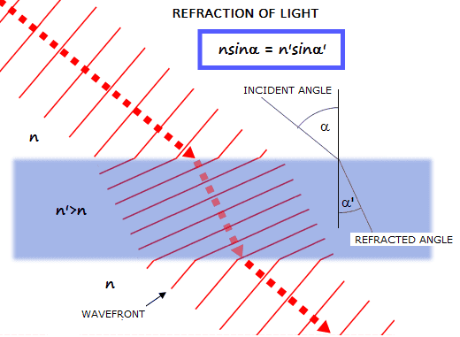

greypilgrim said:
Now I did this for a couple of random numerical values and got exactly the same angle as with Snell's law.
That's surprising if you used an axle of constant length. In most wavefront diagrams the beam width seems to change.
From: https://www.telescope-optics.net/reflection.htm

I lean towards coincidence. The underlying physics is very different, and (besides @A.T.'s comment about beam width) you get different behaviour at the boundary - rigid rotation versus discontinuous slope.

All physical systems can be expressed that way. But look at the diagram in post #5, specifically a wavefront crossing the boundary. Will an axle ever have that shape? If not, an axle is never going to accurately model a wavefront crossing a boundary, however complicated a mathematical approach you take.
No, but neither will a real wavefront be clipped off sharply on the sides as in this diagram.
