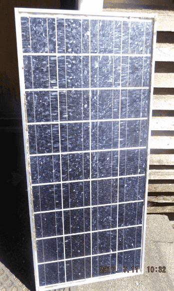

I have a very simple question about solar photovoltaic systems. We all know that they have limited efficiency. Suppose there is a module that is 10% efficient i.e. it can convert 10% of sunlight falling onto it into electricity. I just want to know what will happen to the rest 90%? I mean do those just reflect back like a mirror or some change may occur in their composition?
A small amount is reflected but the major portion is degraded into heat.
As far as I can remember that I have seen photographs of solar cells that shines almost like a mirror. If what you are saying is true, that means that maximum amount of sunlight will be absorbed by the materials of the solar cell. A small portion is converted into electricity and the rest will be radiated as heat. In that case, concentrated solar photovoltaic technology would be simply impossible due to generation of excessive heat.
As per thermodynamics, maximum amount of sunlight will be converted into heat. But does that mean that the solar cell itself converts the unused sunlight into heat and radiates it?
Look again; they are dark blue (probably from a small amount of sky reflection) or black.

ps. Have you ever seen my solar panels? They are a beautiful dark blue.:
And hardly any glare.

Haven't you seen glare off of a window/windshield/lake before? The covering of the panel can be 95% clear, but if it reflects 5% of the light straight into your eyes, it will be blindingly bright.
The answer is confusing.
Solar panels are black, so they absorb light, which makes them get hot. It's that simple. I suspect you were getting at some sort of process related to the generation of electricity that also generates heat, but that's a no.
In the article, it has been clearly shown how reflection increases with increase in angle of incidence. Solar panels fitted with solar tracking always face the Sun i.e. the angle of incidence for them is always nearly 90°. Do you think that reflection parameters are same for them too?
Are you hear for an answer to a question or to push an agenda?
pranj5 said:
Kindly read this https://www.solarsmartllc.com/?p=2942. For this reason, solar panels now are looking like this. If the amount of reflection is small, why anti-glare glasses are needed. The graph below clearly shows that with increasing angle of incidence, the amount of reflection also increases and at 90 degree, the reflection coefficient is more than 70%.
Read it again: it says degrees from normal incidence. That's low angles, not high angles. I ask again: haven't you ever seen glare off anything?
