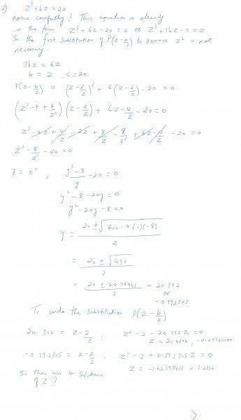

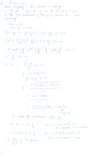

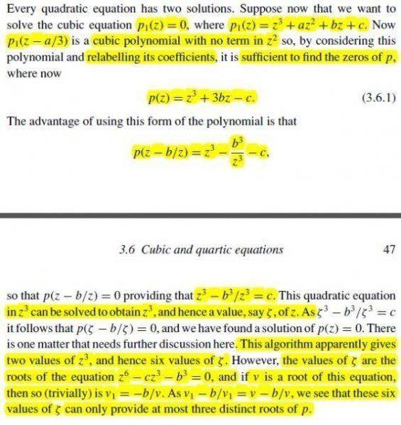

Solve the equation ## z^3 + 6z = 20 ## (this was considered by Cardan in Ars
magna).
Please see the 2nd attachement.
I want to know if my solution is correct because the book (2nd attachment) says that there should only be 3 distinct solutions. I get 4 distinct solutions. My method is also slightly different from the book because I don't understand v and v1 etc...
Please explain to me how to solve cubic equations by the method explained in this attachment only. I don't want to solve this by euler's or any other method.
For my attempt please see the 1st attachment
Danke...

I have rewritten the first attachement in latex format below.
## z^3 + 6Z = 20 ##
Notice carefully! this equation is already in the form ## z^3 + 3bZ - C = 0 ## so the first substitution of ## P(z - a/3) ## as given in the text in the 2nd attachemtn is not necssary.
3bZ = 6Z
b = 2
## (Z - 2/Z)^3 + 6(Z - 2/Z) - 20 = 0 ##
## (Z^2 - 4 + 4/Z^2)(Z - 2/Z) + 6Z - 12/Z - 20 = 0 ##
after cancelling some terms
## Z^3 - 8/Z^3 - 20 = 0 ##
substituting
## y = Z^3 ##
## y^2 - 8 - 20y = 0 ##
solving the quadratic equation gives 20.392 or -0.392305
## y = 20.392 or -0.392305 ##
To find the original Z in the equation ## z^3 + 6Z = 20 ##
we must undo the substitution ## p(z - b/z) ##
so ## 20.392 = Z - 2/Z ##
solving this quadratic gives Z = 20.4896 or -0.09761044
so ## -0.392305 = Z - 2/Z ##
solving this quadratic gives Z = -1.62390451 or 1.2316
so there are 4 solutions for Z?

I will point out your error but will not give you the complete solution.
You want to solve an equation ##p(x) = 0##. You set ##x = Z - 2/Z##, so your equation becomes ##p(Z - 2/Z) = 0##. You find that the function ##Q(Z) = p(Z - 2/Z)## is quadratic in ##Z^3##, so you can find its two roots, say ##r_1= 10 + 3 \sqrt{3} \doteq 20.39230485## and ##r_2= 10 - 6 \sqrt{3} \doteq -0.39230485##.
After this point you make serious errors: you say that you must solve ##Z - 2/Z = r_1## and ##Z - 2/Z = r_2##, but this is not true. Your roots ##r_1, r_2## are values of ##Z^3##, so you need to solve ##Z^3 = r_1## and ##Z^3 = r_2##. That will give you 6 values of ##Z##; two of these are real and the other 4 are complex numbers.
Now find ##x## from ##x = Z - 2/Z##. If you proceed carefully you will find that the seemingly 6 separate values of ##x## (corresponding to the 6 values of ##Z##) actually collapse into 3 distinct values, each of which is duplicated twice. One of the ##x##-values is real and the other two are complex.
