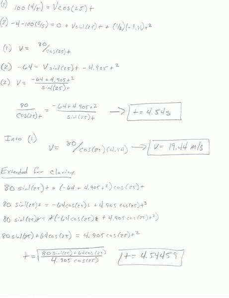

Ok forgive me as an engineering student but this problem should be easier than it seems. The Problem: It is observed that the skier leaves the ramp A at an angle (Theata=25 degrees) with the horizontal. If he strikes the ground at point B, determine his initial speed,V, and the time of flight,t.
I have used:
s=vt
s=s+vt+1/2at^2
The dimensions needed are correct and are 100m down the slope alligned, the ramp he leaves from is 4m high and the ramp is angled at a 3,4,5 triangle.
This problem is 12-110 from the Hibbeler Dynamics 12th edition
I have setup the equations as
(1) 100(4/5)=Vcos(25)t
(2) -4-100(3/5)=0+Vsin(25)t+(1/2)(-9.81)t^2
I have tried solving (1) for t and plugging in into (2) but come out with a strange decimal and also solving (1) for V and plugging into (2) I can't seem to get it.
I know the answers are supposed to be: V=19.4m/s t=4.54s
Please help!

A 3-4-5 right triangle does not give you a takeoff angle of 25 degrees.
Sorry about the confusion and I am aware that a 3-4-5 triangle does not make a 25 degree takeoff. Here is a free body diagram to help describe. The equations are correct btw, I just can't solve the system. Thanks for the help.

Ah, that helps. Where did the "-4" come from?
EDIT -- Oh wait, I see the ramp 4m offset in the figure now.
So as you said, you have two equations and two unknowns. How can you go about solving for V and t?

Yeah I need to solve for V and t.
So have at it! What would be a good way to start?
? I just ran through it again and it worked out. Unbelievable. I guess what thy say about walking away from the problem and coming back to it later really works. I am going to post my work. Thanks for your help.
Great! Good job.
Here is the work. It's a bit sloppy because I ran through it. Please excuse the mess.
