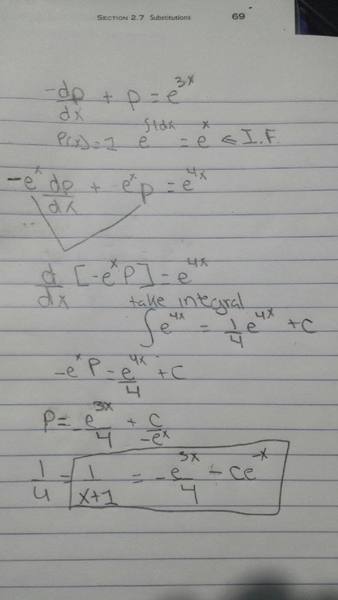

I have no idea where to use a substitution
but after dividing by u^2 I get
(1/u^2)du/dx +1/u=e^3x
p=1/u
Dp/Dx=-1/u^2 du/dx
=========^^^^^^^^^^This looks like the left side of my equation.
(i pulled out the negative as a scalar so it matches my equation)
-dp/dx + p =e^3x how does that look so far?

Looks great! Keep going! That's a pretty simple form.

Very welcome, but you've got a sign wrong. Write that as dp/dx-p=(-e^(3x)). P(x)=(-1)!

oh i see what you did there. you multiplied by -1.
ill make the correction right now.
Dp/dx - p=-e^(3x) p(x)=(-1)
That means my integrating factor is
e^-(x)
e^-(x)dp/dx -e^-(x)p=-e^(2x)
d/dx[e^-(x)P] = -e^2x
take the integral of ^
-(1/2)e^2x
e^-(x)P= -(1/2)e^2x + c
p=1/u
divide the e^-(x)
1/u= -(1/2)e^3x+ce^x
u=x+y
1/x+y= -(1/2)e^3x+ce^x
how does that look?
how would i solve for Y? :)
that took a long time to figure this whole thing out, but its satisfying feeling.
thanks once again dick for helping me, and baby stepping me along the way lol :)

That looks much better. You don't necessarily have to solve for y. But I think if you put your mind to it, you can. Just try. You aren't that bad at this.
