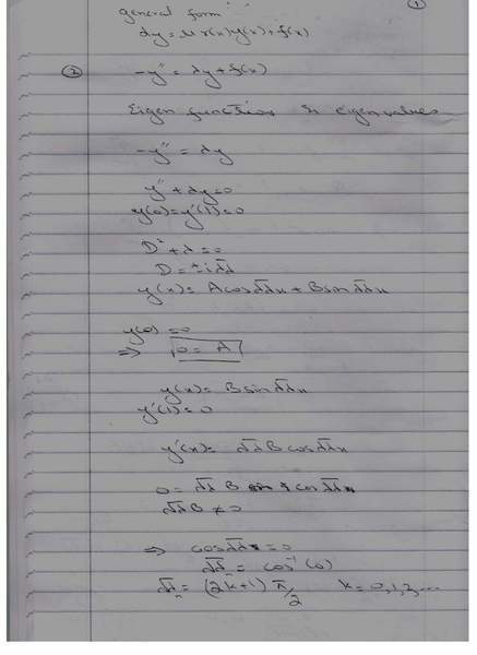

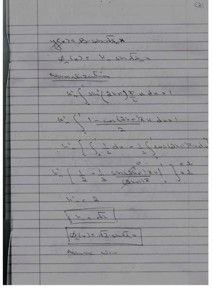

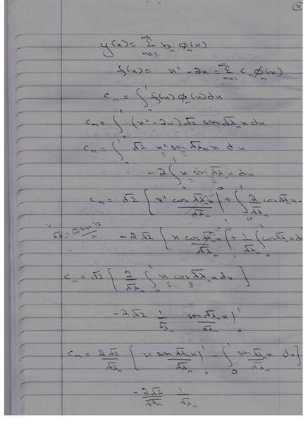

faiza muneer
Find eigenfunctions and eigenvalues to the operator
Ly=-y''
boundary conditions are y(0)=y'(1)=0. express f(x)=x2-2x as aseries of the eigenfunctions. use this to calculate [tex]\sum[/tex][tex]\frac{1}{(2k+1)<sup>6</sup>}[/tex]
i attempted as shown in attached files but did not get the right answer can anyone help me

Your results, so far, look okay to me. You need to decide on whether your index variable is going to be called n or k. Stick with just one. Also, the summation should start from n=0, not n=1.
