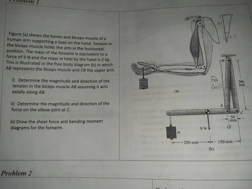

Finding missing force on a (beam)
Basic trig
Can anyone help me solve the magnitude and direction of force at C.
I've managed to get a value for AB. Using basic trig and substituting into F= ((9x150+19.62×350) / 50) / cos9.782
Therefore producing an upward force at AB=166.7N
when it comes to force @ C.. I'm lost!
The reaction force at fulcrum C should be the summation of all the forces in x and y.
The mechanism is in equilibrium, regarding forces and moments.
Without that reaction force at C, the forearm will rotate counter-clockwise about point A, and A will move towards the right some.
Do a summation of moments about point C, on which ##F_{Ay}## and ##F_{Cy}## and ##F_{Cx}## are irrelevant.
You could then calculate the values of ##F_{Cx}## and ##F_{Cy}## via summation of forces on x-axis and y-axis.
