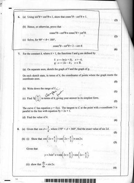

thomas49th
645
im stuck on the top question on part B
i can do the difference of 2 squares on the LHS but how do i get rid of the cosec²x - cot²x ??
Thanks
mis-post, oops!
Edit: Well, as I'm here...
[itex]cosec^2\theta - cot^2\theta = 1[/itex]
[itex]cosec^2\theta + cot^2\theta = -1[/itex]
Well, that's the RHS...
[itex]-cot^4\theta = -cot^2\theta \times cot^2\theta\newline[/itex]
[itex]= (1 - cosec^2\theta)(cosec^2\theta - 1)\newline[/itex]
[itex]= -1 + cosec^2\theta - cosec^4\theta - cosec^2\theta\newline[/itex]Back to the original question!
[itex]cosec^4\theta - cosec^4\theta - 1 = - 1\newline[/itex]
[itex]-1 = -1[/itex]I think that's correct :S
(Hmm, latex is messed up, how do I make a newline?)
Use the result in part a) like it told you to.
3lliot, please do not give out answers. We offer free help here at PF, not free answers.
