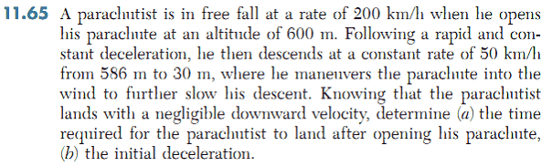

Hello,
I'am doing some selfstudy to aqcuire more experience with mechanics. I got a geat book I'am currently reading. But got stuck in a question I can't answer...
I hope you guys can get me on the good track, just need an approach to tackle te problem. Did already solve problems,but this one seems odd to me...So I wait for good tips. Thank you.
you have an initial velocity/position 200*10^3, 600
you know that deceleration is constant
you have a final velocity/position 50e3, 586
find the time it takes to go 14 feet with constant deceleration from 200e3 to 50e3
then, at 30 meters, he decelerates again, to zero m/s
so find that time, and sum them up
[tex]a=constant, v(t)=-a.t+v_{0}, x(t)=-a\frac{t^{2}}{2}+v_{0}.t+x_{0}[/tex]
Initial conditions:
[tex]v_{0}=55.56 m/s[/tex]
[tex]x_{0}=0 m[/tex]
Situation after [tex]t_{1} sec.[/tex]:
[tex]v(t_{1})=13.89 m/s[/tex]
[tex]x_(t_{1})=14 m[/tex]
Rewrite equations:
[tex]-a.t_{1}=13.89-55.56=-41.67 m/s[/tex]
[tex]14=(-41.67).\frac{t_{1}}{2}+55.56.t_{1}=(-20.84+55.56).t_{1}[/tex]
Solution:
[tex]t_{1}=0.4032 sec.[/tex]
This answer is the input to the velocity equation to get the constant decceleration, which is [tex]103.3m/s^{2}[/tex]
Travel time to reach the 30m position: [tex]\frac{556m}{13.89 m/s} = 40.03 s[/tex]
Total travel time so far: [tex]40.43 s[/tex]
The decceleration time tot reach ground level can be get with the same procedure.
Total travel time: [tex]44.73 s[/tex]
Thank for the good help, relative easy problem actually.
