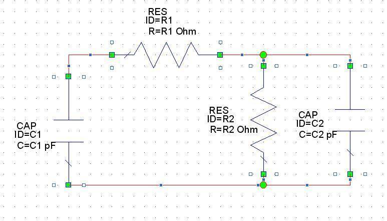

Hello All,
I'm having problem to solved the attached RC circuit.
The initial conditions are: VC1(0)=V, VC2(0)=0, and the qeustion is what will be the VC2 after t1 (t1>>0)?
but i always get VC2(t1)=V which is imposible.
I'm solving it by using i=cdv/dt
3. The Attempt at a Solution is as follows:
VC1=VR1+VC2
I=I2+I3 (I2 is the current throgh the R2 and I3 is throgh C2)
It/C1-VC1(0)=(I2+I3)/R1+VC2 -> (I2+I3)t/C1-VC1(0)=(I2+I3)R1+VC2
This is the basic after that I'm putting I3=C2dVC2/dt and I2=VC2/R2
I'm solving the equation and getting wrong answer of VC2(t1)=V.
t1>>0.
Thanks you

Another and much easier approach you may want to take is to find the time response, and find v(infinity), v(0+)
