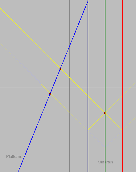

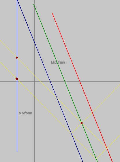

train space-time plot
There is talk of 'someone sees the light reach...' but the only way to know this has happened is for a light signal to reach the observer from that point. The space-time plots show that any observer not in the middle of the rain sees two flashes at different times on his clock.
The first picture shows the trains point of view. The light strikes the back and front at the same time. The second picture shows the platforms viewpoint. The light reaches the ends of the trains at different times.
