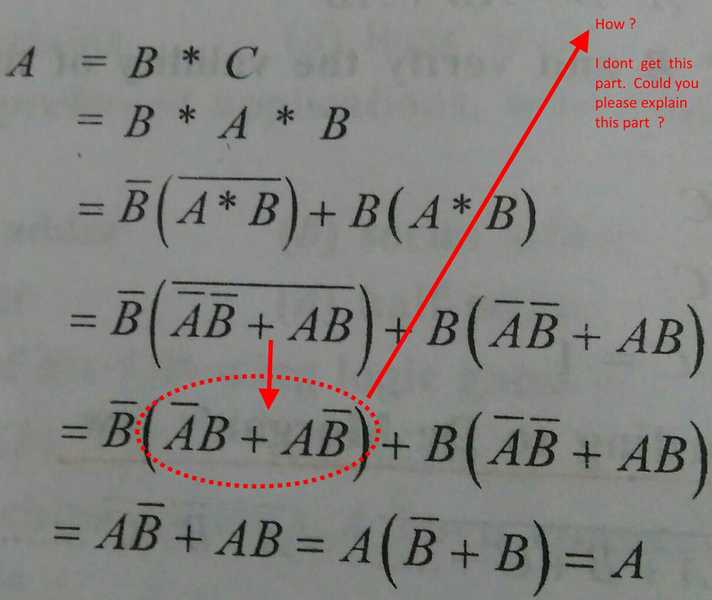

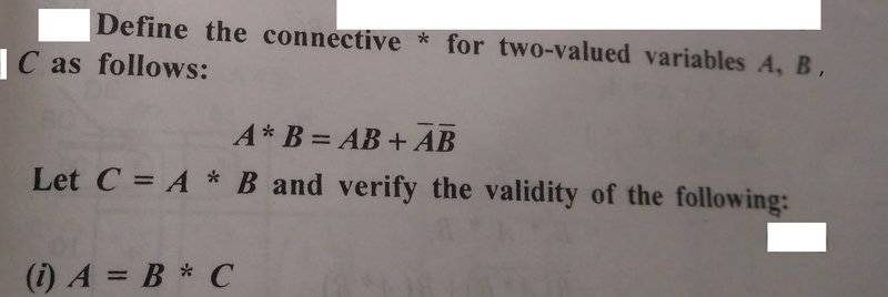

Here is the problem statement in my book
Here is the solution as per my book

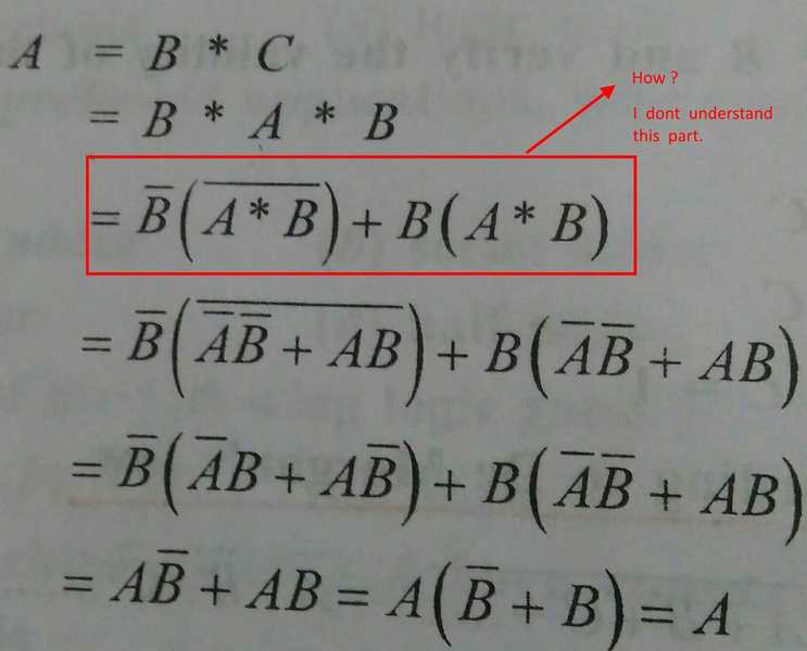

I don't understand that marked part. Is that correct? Can we write that? How?
Need help to understand that part.

It might be easier to follow if we put the implied parentheses in:
\begin{align*}
A&=B*C\\
&=B*(A*B)\\
&=\overline{B}\ \overline{(A*B)} + B (A*B)
\end{align*}
In the last step they are just applying the definition of the '##*##' operator to the first instance of '##*##' in the second line.
Another way to look at it is:
\begin{align*}
A&= B*C\\
&= BC + \overline B\ \overline C\\
&= \overline{B}\ \overline{(A*B)} + B (A*B)
\end{align*}
Thanks. I am clear on that part now...very nice.

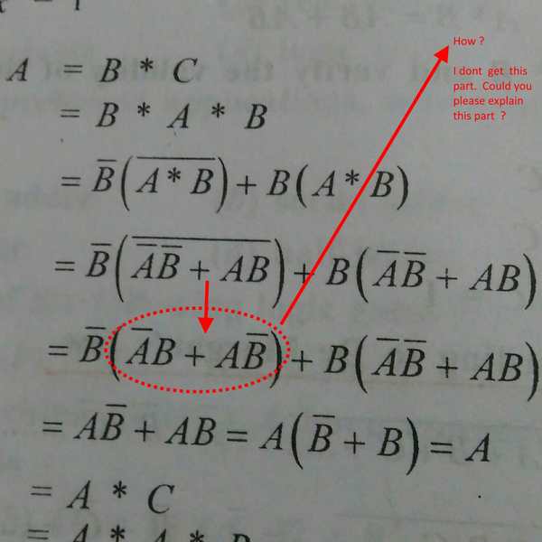

How the next step working. Is it any law? Could you please elaborate more on this red part below?

To get to the circled expression, the author has used DeMorgan's Laws several times.
##\overline{\bar A\bar B + AB}= (\overline{\bar A \bar B}) (\overline{AB})##
Can you continue from there? This expression does simplify to ##\bar A B + B\bar A##.
You will also need to use the fact that for a Boolean variable B, ##B\bar B = 0##

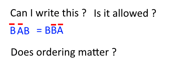

one more query ,
I just rearranged those values ...I am not sure if this is allowed ...could you please confirm ?

Yes, the Boolean AND and OR operations are commutative, so ##\bar B \bar A B = \bar A \bar B B##, which can be further simplified to ##\bar A##.
Edit: ##\bar A \bar B B## simplifies to 0.
