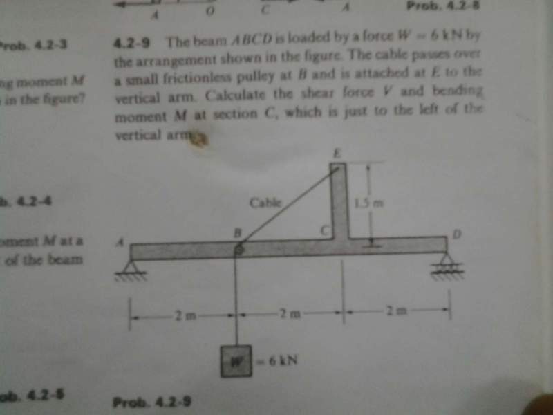

I have attached the question in image format.

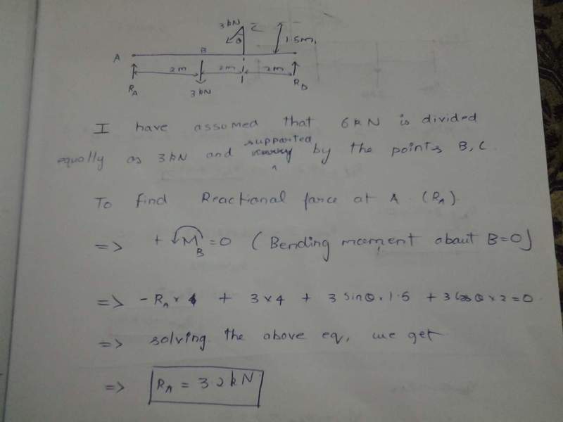

I attached my attempt at solution as images.
Kindly have look at them.

No images have been attached...
Sorry, it was not uploaded properly. It's available now.
I would re-check your resolution of the tension in the cable holding the 6kN weight. I don't get your components.
