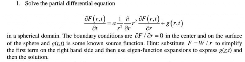

I have a PDE and I need to solve it in spherical domain:
$$\frac{dF(r,t)}{dt}=\alpha \frac{1}{r^2} \frac{d}{dr} r^2 \frac{dF(r,t)}{dr} +g(r,t) $$
I have BC's:
$$ \frac{dF}{dr} = 0, r =0$$
$$ \frac{dF}{dr} = 0, r =R$$
So, in spherical coord.
First, I know that:
$$F=w/r$$
Reducing, I get:
$$\frac{dw}{dt} =\alpha \frac{d^2w}{dr^2}+r*g(r,t) $$
[/B]
After I Get this, I need to find eigenfunction expansions to express the source term and
then, finally, the solution Do I need to do separation of variables? I am confused at this point and not sure how to proceed.

I should be more specific. The problem is attached for complete clarity, noting that I need to state any assumptions. The reason I haven't started is because I am not fully sure how to start. Should I Start with separation of variables? Should I start with identifying a proper eigenfunction? Would it be of the form sin(...).
  • Typed problem statement: solve the PDE dF/dt = a(1/r^2)(d/dr)(r^2 dF/dr) + g(r,t) in a spherical domain, with dF/dr = 0 at the center and surface, hint F = W/r.
