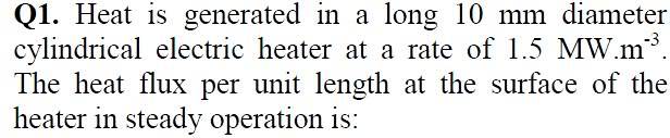

Solving a Short Heat Question with q = Q/A - Area Calculation Help
  • Thread starter Thread starter Studious_stud
    Heat Short
6 replies · 2K views
Studious_stud
38
q = Q/A where q = heat flux, Q = rate of heat transfer, A = area
Well I guess my main problem is figuring out the area. I know the answer to the question, but I can't seem to calculate it right.
Thanks everyone
What is the total power output (in W), letting r be the radius and L be the length of the cylinder? What is the surface area of a cylinder, ignoring the ends (which are negligible for a long cylinder)?
I don't know, those are the only variables given in the question.
Yes, I'm asking you to calculate both quantities as part of solving the problem.
Well, I know the surface area is 2pi rh. However, I don't think I've ever seen a formula relating power to radius or length..
Mapes said:
You're given the power output per volume, yes? And the volume of the cylinder is easily calculated.
Ahh, I got it now. Thanks!
