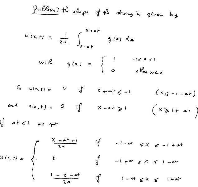

Handwritten solution to a d'Alembert wave problem: u(x,t) = (1/2a) times the integral from x-at to x+at of g(s) ds, with g(x) = 1 for -1<x<1 and 0 otherwise, giving a piecewise formula for u in three cases.
please see the attachement
Could somebody explain how to get the the system of equations at the bottom of the page from integrating g(x)?
I attempted to integrate, but couldn't get the right answer, do I need to subtract the previous integration from the current one?

g(x) = 1 when -1 < x < 1, and g(x) = 0 otherwise
how do I get
u(x,t) = (x+at+1)/2a for -1-at < x < -1+at
= t for -1+at < x < 1-at
= (1-x+at)/2a for 1-at< x<1+at
