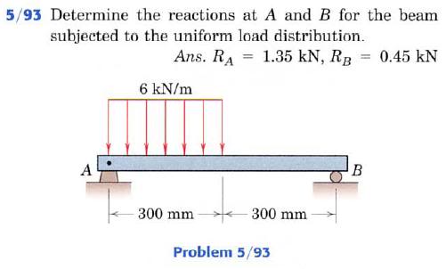

To find the reaction at A and B. (See image below)
Moments and Area
Area of load: (0.3)(6) = 1.8kN
Moments about A: -(6)(0.15) + RB(0.6) = 0 --> RB = 1.5kN
4. The error and question
I get the reaction force at B to be 1.5kN but the answer states that it is 0.45kN. What am I doing wrong?
"-(6)(0.15) " is wrong.
Oh yes. It's -(1.8)(0.5). Found 1.8 in the step earlier and forgot to put that in. Thanks.
Also, what is that dot they have in the bar mean? At point A.
