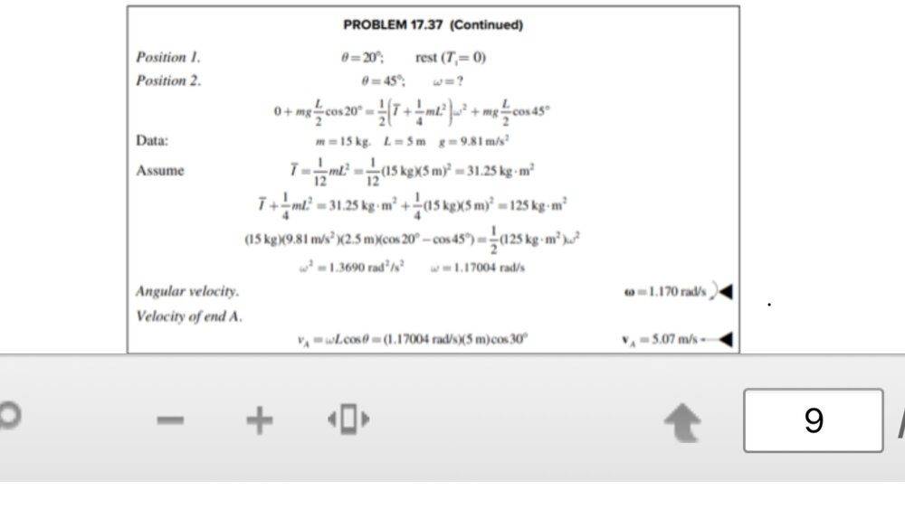

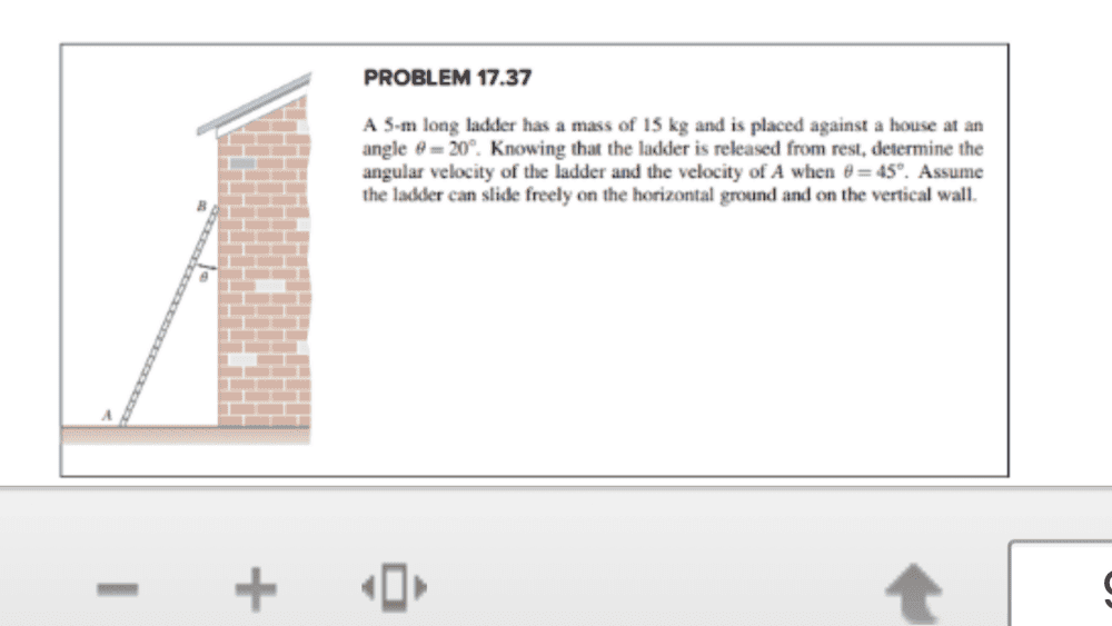

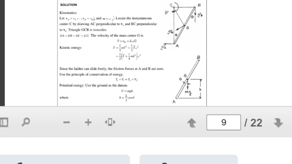

So for this question I got the right angular velocity. But I don’t get the same velocity for point A. I don’t understand why it’s cos30, problem asked for V_a when theta = 45 so I used cos45. I have my work below.
