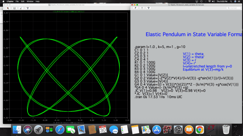

I simulated this elastic pendulum using LTSpice. I set the problem in terms of state variables according to this paper which suggests Spice as a powerful general purpose tool for almost any dynamical system.
https://www.eng.auburn.edu/~wilambm/pap/2011/02_ijee2410ns.pdf
It's a powerful tool. I've even done quantum simulations with it. The entire code to run this system is here with V(1)=##\theta##, V(2)=##\frac{d\theta}{dt}##, V(3)=##r##, V(4)=##\frac{dr}{dt}##;
.param l=1.0, k=10, m=1 , g=10

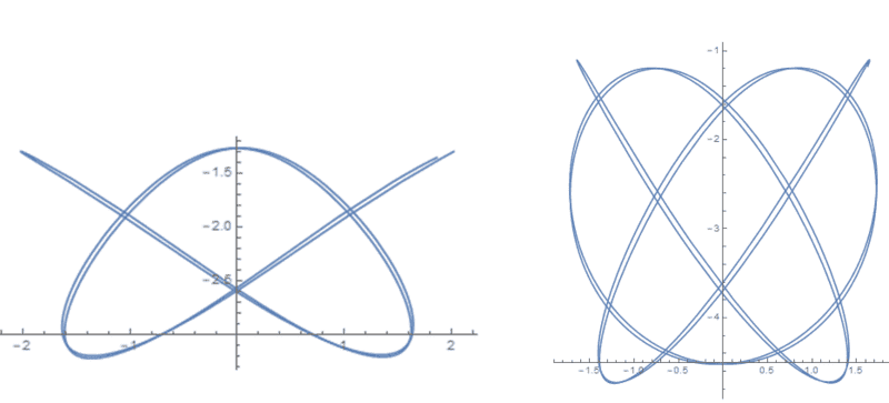

The output is as close as I could get it to match the Wikipedia page (since I don't know the exact conditions I had to try and match the curves). It's not an absolute match but close except for the artifact at the start (I removed that thanks to @Baluncore ).

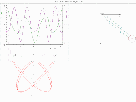

The Wiki page has this simulation;
Here is another one with a few changes. Looks like a pretzel;
2025 Award
- 17,231
- 10,700
There is not much circuit there, only five nodes.bob012345 said:The next step would be to do it as a circuit.
The order of lines or blocks of text does not matter in spice, unless there is a .end, which stops the process, so depending on the order of processing, some lines may be missed. LTspice does not need a .end directive. Remove the .end and .probe directives from the block of code. Then you can start breaking up the text block, and making the circuit.
In the .tran directive, introduce a 1 ns "time to start saving data" delay. That will prevent display of the initial diagonal step transient.
bob012345
- 2,419
- 1,110
By circuit I meant using a series of integrators, summers, inverters, multipliers and such as is done in analog computers not converting this state variable format directly to a circuit diagram format with programmable conductances. Of course the ease with which one can run virtually any dynamical system this way makes it seem almost like cheating. Here is an example of a simple damped mass-spring oscillator in analog circuit form;Baluncore said:There is not much circuit there, only five nodes.
Thanks for the tip on the delay to remove the artifact!
2025 Award
- 17,231
- 10,700
I guess you want to eliminate all G and B sources, along with expression evaluation.bob012345 said:By circuit I meant using a series of integrators, summers, inverters, multipliers and such as is done in analog computers not converting this state variable format directly to a circuits diagram format.
The reason spice can be fast here, is that the number of state variables, or nodes, can be minimised to four and a common ground. This is really the simulation of a hybrid computer, the currents integrated in the virtual capacitors are generated directly from the digital equations, not by simulation of the many op-amps with feedback, needed to make multipliers, and a divider, with coefficient resistors to convert the voltage terms to currents. That will introduce a great number of nodes into the sparse matrix, which will slow it all down.
The fastest LTspice circuit simulation would use an arbitrary behavioral current source, B, in place of a G, (which has only one differential control input).
B1 0 1 I={ V(2) }
C1 0 1 1
R1 0 1 1T
B2 0 2 I={( -2*V(2)*V(4) -g*sin(V(1) ) )/(l+V(3)) }
C2 0 2 1
R2 0 2 1T
B3 0 3 I={ V(4) }
C3 0 3 1
R3 0 3 1T
B4 0 4 I={ (l + V(3))*(V(2))**2 -(k/m)*V(3) +g*cos(V(1)) }

As a check, I used Mathematica to solve the differential equations. I get the same results as @bob012345 for his two examples:
The axes are scaled a little differently.
Using software for electric circuits to numerically solve the equations of motion of a mechanical system is really neat.
