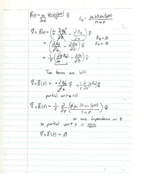

Now plugging in B(t) into ampere's law, I run into trouble when solving for the time varying electric field. Particularly when calculating the curl of B(t). I always get zero.
Am I setting this problem up correctly? Any hints as to where I went wrong?
Sure, well the ##\nabla \times B## is not zero because the field is sort of circular. You wrote that it is in the ##\theta## direction. That is correct; if you surround the wire by a circle, the field would be tangent to the circle. Show me how you calculate the curl. Stokes theorem gives a relationship between the curl of B and the the product of ##|B|## times the circumference.

Gene,
Please see this link, this is how I solved the Curl of the Magnetic Field

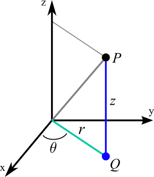

Here is a diagram of the coordinate system I used.
Theta starts at the positive x-axis and rotates towards the positive y axis.
r = rho , which is the distance away from the z axis.

Gene Naden said:
Hi there,
Could you please tell me which way is the Z axis going? And the x and y axes?
It would be easier to use Stokes theorem. You just integrate around a circle.
Regards,
Gene

Which way is the current going in your coordinate system, please?
Gene,
In my problem, I stated AC current. The current waveform is modeled by a sinewave, so half the time it is in the positive z axis and half the time it is in the negative z axis.
I guess, I don't understand why you wouldn't just integrate in cylindrical units as opposed to cartesian, because this problem was set up in cylindrical units.
Actually, I misled you. ##\nabla \times B## is equal to zero outside the wire. It is only nonzero along the wire where ##\rho=0## (where the current is).
So I think your calculation of the curl is correct. And you have the right dependence of the magnetic field on ##\rho##. It is inversely proportional. And the magnetic field alternates back and forth as the current alternates. The question in my mind is whether or not this produces an electric field. At low frequencies (like 60 Hz), I would say the electric field is negligible.
