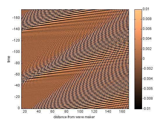

I have a further question regarding these results.
My results are shown below.
There are two things that are bothering me. For one, MATLAB has indexed my time axis backwards, so in order to plot my time values appropriately i have to make them negative. Is there an easy way to fix this?
The second thing is that because this solution is periodic, I'm seeing artificial "noise" from the other solutions. Is there an easy way to remove these unwanted solutions so that I just display, in effect, the primary branch?
Thanks,
Nick
flip the matrix:
http://www.mathworks.com/help/techdoc/ref/flipud.html
not sure what you're talking about exactly, but you can reduce noise by either smoothing (matlab's smooth function is god-awefully slow though, I'd suggest the fastsmooth on the open file exchange) or by just low-pass filtering (assuming the noise is a reasonably higher frequency than your data-of-interest).
Thanks for the responses, Pythagorean.
My first problem was solved using set(gca,'YDir','normal');
As for the second problem, I'll try to quantify what I mean a bit more. I believe what we are observing in the previously appended plot are three solutions. Call them f(x,t), f(x,t-tau) and f(x,t+tau) where f(x,t) is the solution that I'm interested in and is the one that originates around t = 40-60 seconds. I believe that these other solutions, f(x,t-tau) and f(x,t+tau), are simply an artifact of the periodicity of solutions when using the Fourier transform. To me, these solutions represent noise and I would like to remove them so that all I have left is f(x,t).
I have been experimenting with creating filters in Fourier space to try and remove this unwanted information but so far have been unsuccessful.
As usual any help would be greatly appreciated!
Nick
Well, filters will take out frequency components; but the way you've stated it, you're trying to remove temporal components? Is this correct?
you can move between temporal shifts and frequency via the "shift theorem"
what i ended up doing was padding my initial signal with a sufficient number of zeros such that the period becomes extremely large - this way the unwanted periodic noise is no longer an issue in the domain that i care about.
thanks for all of your help,
nick
