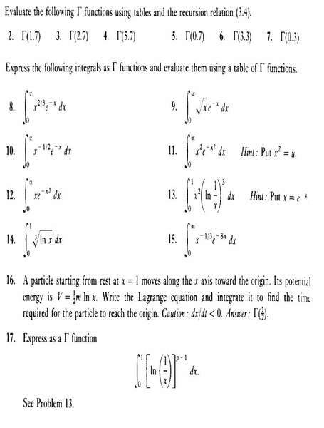

Questions are in picture.
$$ \int _{0}^{\infty }x^{n}e^{-x}dx $$ = $$ Gamma (n+1) = n!
$$ Gamma(P+1) $$ = $$Gamma(P)$$
$$ Gamma(P) = (1/P) $$Gamma(P+1)$$
2) I have found it from table.
3) I have used recursion and table to find it.
4) Again With recursion.
5) $$ \Gamma(0.7) $$ = 1/p(p+1) with this formula.
8) If $$ \ Gamma (p+1) $$ is equal to this integral,I think it can be written as $$ \ Gamma (2/3+1) $$ later we can found the value from table.Am I right?
Same logic again for 9,10?
But what next? How can I convert them to Gamma function?
11) I found 1/2 but I'm not sure(?)
Edit : No it's not true.I think true solution is on down.

5. 1/0.7(Gamma1.7) = 1.30 ? Isn't it?
I'm sorry questions mess up.It's solution of question 11.
Here is for (8)
For n= 2/3 Gamma(n+1) = Gamma(1+2/3)=Gamma(1.6) = 0.89
Yes.
But you haven't done the substitution correctly. What will dx become?
Here is for (8)
OK, but 1.6 is a bit inaccurate. The answer should be > 0.9.
Yes.There's a problem.But I can't figure. if we say u=x^2 --> 2xdx=du --> dx = du/2x Where to go from here? I can't remember how can I escape from x variable?
Just replace the x using u=x2
I understand but what about dx ? Would be? x^2=u 2xdx = du dx = du/2x (I'm asking about this x?)
$$ \int _{0}^{\infty }ue^{-u}? $$
dx = du/(2x)
or
dx = du/(2sqrt(u))

Can I use same logic for 12?
x^3 = u
3x^2dx= du
dx = du / 3*√u
∫xe^-x^3 = ∫u^1/3*e^-u du/3*√u= 1/3 ∫ u^-1/6 e^-udu = 1/3 * Gamma -5/6 ...?+ No idea for 15?

Not √u, a little more complicated than that. What is x as a function of u?
+ No idea for 15?
In line with the other substitutions, u=8x looks obvious. Did you try that?
