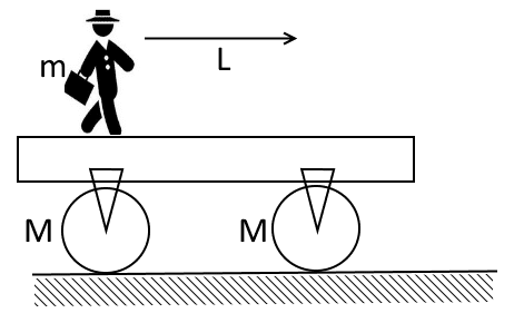

A cart consists of a massless platform and two wheels. Each wheel is a disk of mass M.
The cart stands on a horizontal road and a man of mass m stands upon the platform. Then the man started to go along the cart and after passing the distance L (relatively the cart) he stopped also relatively the cart. The wheels do not slip over the road and there is no friction in the axes.
Which distance the cart passed?

Yes, I like it. ##\frac{Lm}{3M+m}## right?

Angular momentum? That does not seem to me to be the way to approach it. About what axis?
About the axes where there is no friction ! Like in wheels that rotate.
Pick one axle. What forces have moments about that axle? What is the man's angular momentum about it? Would you like to know how tall the man is?
Am I misreading this ? Man wants to accelerate by stepping to the right, platform wants to move to the left. Road stays where it is so reaction force from road is torque on wheel.
Yes, but now you are working with accelerations and torques, as I did. Not any momentum conservation.

t. Lm3M+m\frac{Lm}{3M+m} right?
Yessss!
None of the concepts required are very advanced. Just basic F=ma and τ=Iω, together with the understanding that if two objects have a fixed ratio of accelerations then the same ratio applies to their velocity changes and displacements. UK GCE A level maths, perhaps?

Do you mean regarding displacement ratio? ##\ddot x_2=\lambda\ddot x_1##, ##\dot x_2=\lambda\dot x_1## (both initial velocity zero), ##\Delta x_2=\lambda \Delta x_1##.
I mean that all the formulas must be derived (on mathematical level of rigor) from the fundamental equations of dynamics. And it seems to me that in our case such a derivation is not so trivial task for students. Some people regard such a demand as tediousness and excess.
